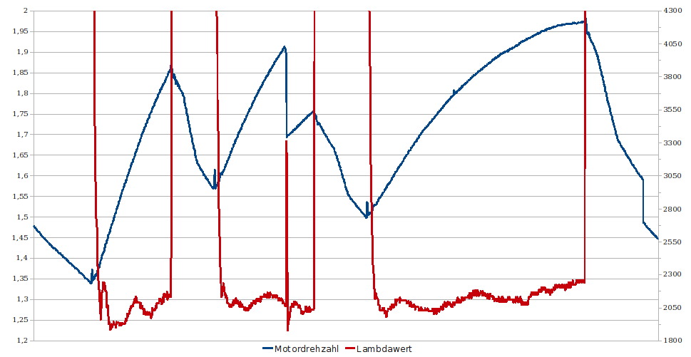

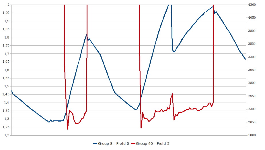

Post21-06-2008, 20:13    Subject: Quote
Rainer K. wrote:
Ouch... at least, in my opinion, ultrasonic cleaning is pointless for injectors that are carbonized, it won't achieve anything in the long run.
I have to reiterate this point because: VW/Audi definitely has a carbon buildup problem with the 125kW PD-TDI engines, and - at least during the warranty period - they perform an ultrasonic cleaning of the injectors if the full-load lambda value exceeds 1.39. In my case, it happened after 60,000 km.
I could hardly believe it myself, but the differences before and after cleaning are strikingly clear. The engine now runs much more smoothly, responds better to the accelerator, and it's amazing how quiet it can be – or rather, how accustomed I had become to a certain level of noise!
Incidentally, these "coke formations" are not visible to the naked eye; they must be microscopically small.
I have attached two charts below showing the Lambda values (before/after). Unfortunately, I had to extract the "before" data from an air mass/boost pressure log from August 2007. If I had known the Lambda relationships before the cleaning, I would have created a clean MWB 74 log right before it. Nevertheless, you can see that the Lambda values are more homogeneous and, overall, lower after the cleaning. So, the cleaning definitely has a positive effect.
EDIT: The corridors in the "after" log are 4-5-6, but unfortunately, I no longer remember which corridors were in the "before" log.
Ah yes, there were also newer versions of the MSG software. The current data status is 2968.
Regards,
Peter.
 NACHHER
 File size:  83.7 KB
 Viewed:  4938 times
 VORHER
 File size:  71.96 KB
 Viewed:  4547 times
Translated on 19-10-2026, 7:29.

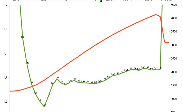

Post06-03-2010, 1:13    Subject: Cocaine Update: News & Information Quote
The plague is back at 105,000 km...
 File size:  27.14 KB
 Viewed:  3171 times
