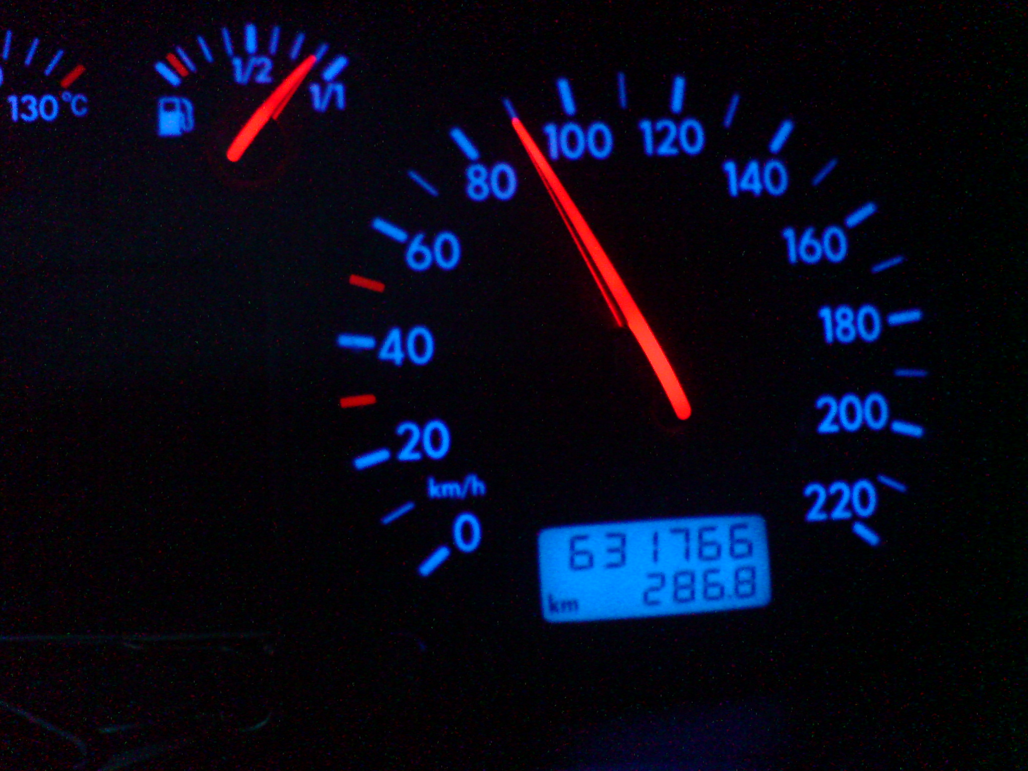

Post05-10-2010, 22:32    Subject: Quote
new theory: our workshop has always used standard 10W40 oil, not low ash oil with DPF approval. The filter is probably slightly clogged, and we wanted to clean it out and then fill it with good DPF oil...
Ascharmes oil doesn't add anything as long as there's no soot. Normally, ACV engines consume very little oil, even with high mileage.
We also have a vehicle with an ACV where a DPF was retrofitted at 460,000 km. Today, it has over 600,000 km and has always used only standard 10W-40 oil, and has had absolutely no problems from the beginning!
 File size:  897.12 KB
 Viewed:  2230 times
