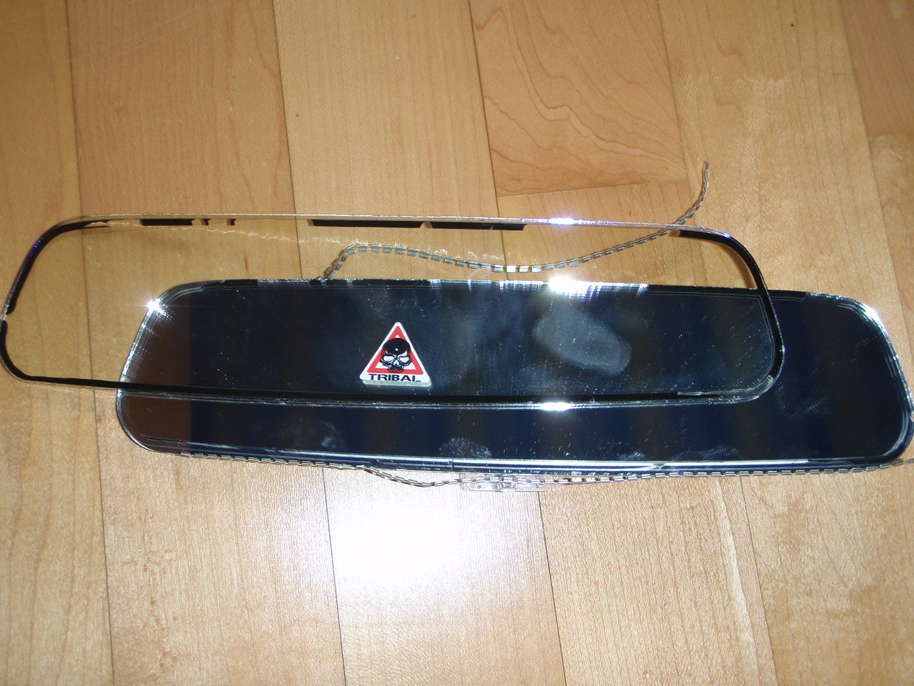

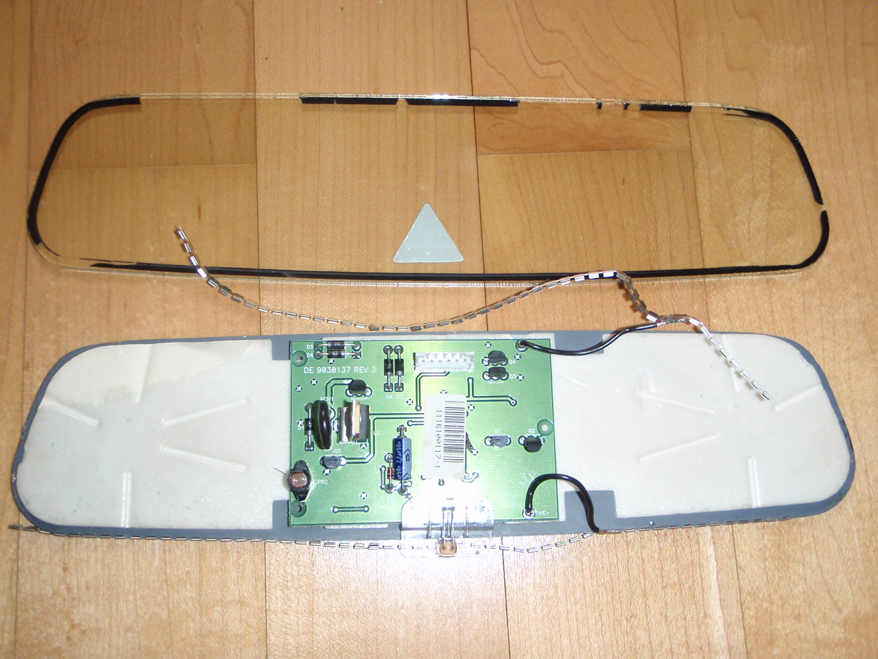

Post15-01-2011, 11:52    Subject: Interior Mirror: Design & Functionality Quote
Okay, done. The mirror for the GTI was completely replaced in just 2 minutes, and it's icon_wink.gif.
Okay, here's a photo I took of the Putten Hig-Tec mirror without its housing.
The sticker with three corners is a memento from my best friend *laugh*. icon_lol.gif
