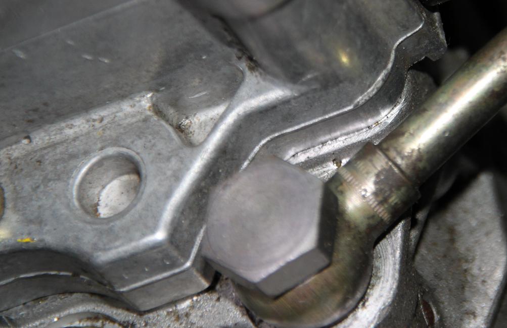

I once took a close-up picture of the VP37, focusing on the ring joint of the inlet pipe; you can clearly see the displacement of the flow control valve, I think. The scratch mark is also not mine, and I only noticed it yesterday. icon_redface.gif
I was unable to observe such a significant shift towards the high-definition portion in two other vehicles equipped with VP37. The VAG-COM values are not yet available...
 Detailansicht VP37

Solution:
Despite the clear visual inspection, the quantity adjuster was found to be full of shavings.
After a complete renovation, the problem is gone.
KW stub and ZR wheel worn out, but only visible after disassembly icon_smile.gif.
Have it planned and a new timing belt wheel installed.
It seems things are going well now, THANK YOU FOR YOUR HELP!
