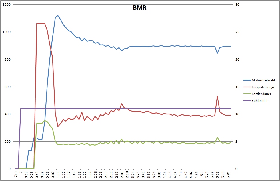

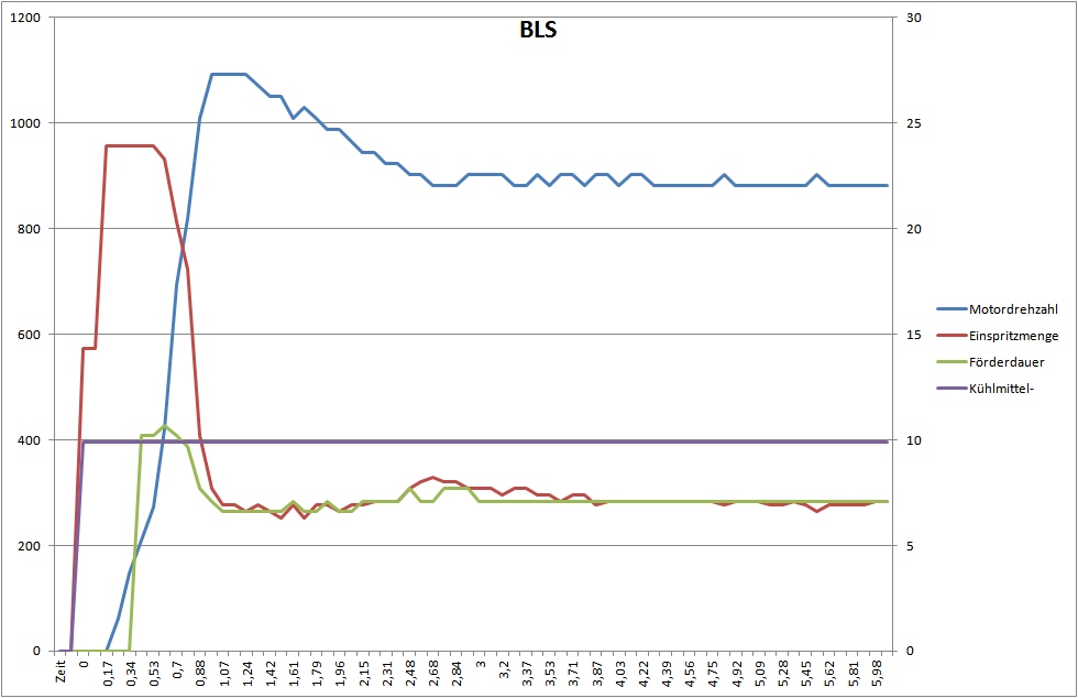

I can't believe it, it's all apparently psychology!
The BMR reached 1.03 seconds, while the BLS reached 0.98 seconds (with a lead time of 0.25 and 0.23 seconds, respectively).
Only the BMR shows signs of work, namely the two steps, until it starts at the third compression.
However, I must also say that the BLS didn't exactly show its best side today.
The trick at the end of the BMR is to slip the clutch.
