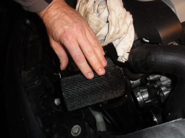

Post22-11-2012, 20:26    Subject: Quote
Hello everyone,
Startled by the new readings, I immediately checked the oil filter. Again, it was black. Not as extreme as the first time, but still black. Then I checked the oil level and was shocked - it was overfilled! I hadn't added any oil since the last oil change. I had to pump out about 1 liter to get it back into the "normal" range. Oil dipstick is coming. I think that is quite new_cry.gif.
The original pump costs approximately €360. A Pierburg pump costs €225. Does she do it or not?
By the way, I read that you can check the fuel pump for internal leaks. This involves disconnecting the supply and return lines at the pump. One of them is closed off and a pressure gauge is connected to it. The other line is pressurized to a maximum of 1 bar, and the air supply is then shut off. If the pressure cannot be maintained, the tandem pump is leaking.
I think I can skip this exam icon_sad.gif.

Post22-11-2012, 20:51    Subject: Quote
Well, in that case, I would also consider replacing the tandem pump.
However, the BMM system, along with its software related to the DPF, can also allow some diesel fuel to bypass the cylinders and enter the engine oil, especially during the active regeneration phase. But 1 liter per kilometer is quite a lot.
reflexsilber met.
Joined: 04/14/2012
Posts: 2130
Location: Nähe Düsseldorf
Post22-11-2012, 21:38    Subject: Quote
A pump from Pierburg costs 225€. Does she do it or not?
Pierburg always delivers. Exception --> LMM.
How many miles have been driven since the last oil change?
I have a similar case here with a Passat 3B6 equipped with a DPF.
He needs approximately 2000 km icon_wink.gif for each liter of oil increase. The tandem pump would then be a likely culprit.
Let's see if he can get it repaired or if he's going to sell it.
