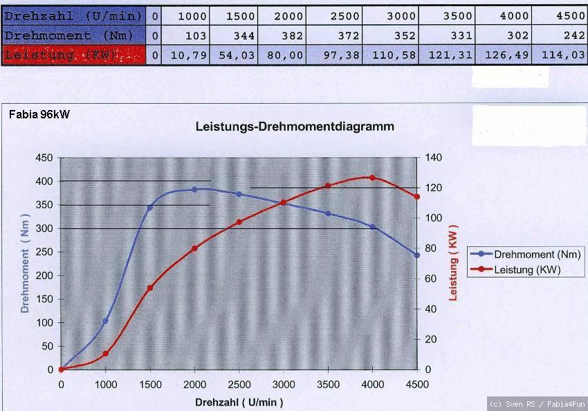

The next level:
Here's an updated "performance" diagram of the same tuner as in the original post: No more slew rate limitations, no more environmental data from the measurement, and perfectly smooth curves like those shown in the datasheet.
(The black grid lines you see are mine; the white areas only contained tuner and customer data.)
Well done, because now it's impossible to tell whether or how much cheating occurred!
This perfectly fits my overall impression of the tuner: They boast about high performance figures at every opportunity, fudge the numbers to get the promised peak power (Pmax) on paper, and now they print "zero-value" charts where cheating is no longer detectable due to a lack of reference data, and they make it as difficult as possible to verify the actual performance increase.
Here's the translation:
"The customer explains with this diagram in the Fabia forum why no pre-performance measurements are taken:
Unfortunately, an initial measurement is no longer performed because, according to the tuner, it is not necessary, as they have already conducted long-term tests on the engines.
Without a prior measurement, the customer doesn't know how much extra performance the tuner has unlocked. This means the tuner can subtly and elegantly exploit the typical variations in standard TDI engine output and attribute it as part of their own success.

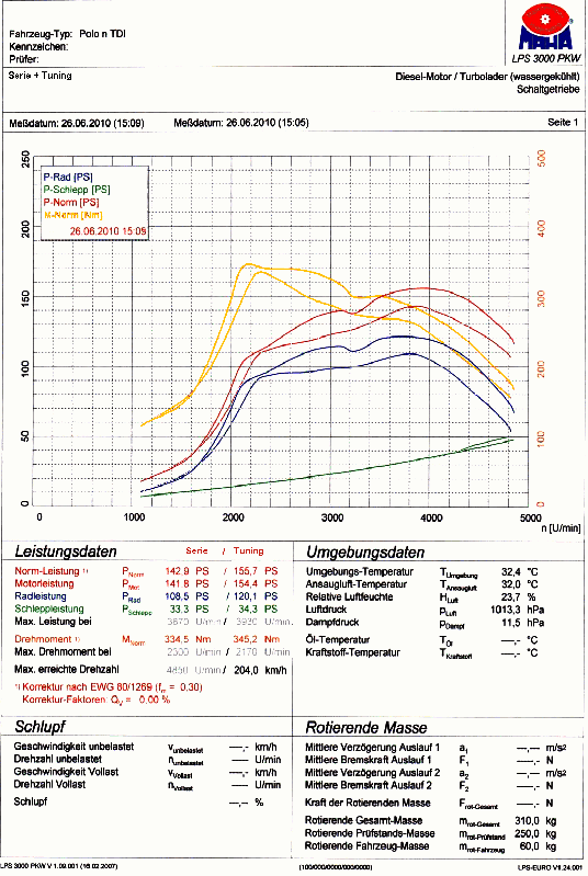

Post21-12-2012, 16:59    Subject: Quote
Follow-up question:
What is the approximate power output range when measuring traction force with a 1.9L TDI engine *without* disengaging the clutch?
Reason:
The attached document shows two superimposed measurements of the same car, using both stock and tuning software. The torque curves are virtually identical, except in the range above 4300 rpm: there, the stock torque reaches its peak at approximately 4800 rpm, which is about 3.4 horsepower higher than the tuned measurement.
Did the dynamometer operator disengage the clutch too late, and does the difference between the two curves indicate the engine's drag power?
My calculation attempt, independent of the diagram:
a) The displayed idle fuel consumption (engine warm, 900 rpm) is usually around 0.8 liters per hour.
b) Energy content per liter of diesel fuel = 10 kWh.
c) Assumed thermal-to-mechanical efficiency of the engine at low load conditions (rough estimate) = 0.15 or 15%.
