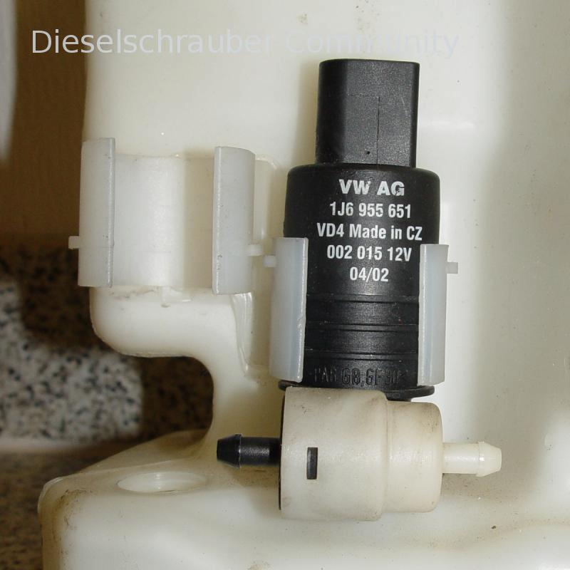

The windshield washer pump on our Polo is leaking when activated. The washing water seems to be escaping from the area where the outer hose connector cover sits on the horizontal distribution cylinder (where the hoses leading to the front and rear windshields are connected), as shown in the picture, specifically at the left fitting.
Has anyone ever disassembled a pump like this (which is used as a universal part with the code 1K6 955 651 in many VAG models, such as Golf and Passat from 2003 onwards, Touran, Sharan, Ibiza from 1993, Leon from 2000, etc.) and sealed it at that specific location?
I'd really like to avoid spending around €40 to buy a replacement for that tiny thing...

Mach den Deckel mal runter. Evt. ist da Ein O-ring oder ähnliches vorhanden. Glue works wonders.

Applying a little bit of glue, silicone, or something similar around a lid definitely makes sense if it can save you about 40€.
The question is simply whether the pump can be disassembled and reassembled without any damage.
If not, and a new pump would have taken several days to arrive, we would have been in serious trouble because Christel would have had to drive every day completely without windshield wipers.

Take it apart and have a look. It's already broken anyway.

I would first try to open the pump. If that's impossible or if opening it risks causing total damage, just leave it alone! You can only seal something with silicone if you can disassemble it. Furthermore, silicone has a limited lifespan and isn't necessarily frost-resistant. It's also unknown how the antifreeze additives in the washing water will react with silicone.
Das bringt mich zur Empfehlung von "Pronova Bitumendicht". Das Zeug klebt wie http://www.radio-dx.eu/Sebastian/Smilies/Scheisse.gif und laesst sich aus der Kartusche mit einer Silikonpresse in Raupen auf die Klebeflaechen aufbringen. Man kann es bei Bedarf auch aufspachteln. Beim Verarbeiten darf man sich etwas Zeit lassen, das Zeug bindet nicht sofort ab oder wird hart. Nach dem Aufbringen drueckt man die Flaechen nur etwas an, die Dichtmasse sollte nicht komplett zwischen den Flaechen herausgedrueckt werden. Herausquellende Dichtmasse kann man wegwischen oder stehen lassen, wenn sie nicht stoert. Surface imperfections, scratches, or cracks are not a problem – they can be easily corrected.
Die Verarbeitung auf nassen Oberflaechen ist moeglich, man koennte also auch im Regen damit arbeiten. Die in Kartuschen angebotene schwarze Masse ist glasfaserverstaerkt, hitze- wie frostfest und bleibt dauerelastisch. Man sollte sie zum besseren Verarbeiten definitiv anwaermen. Gedacht ist diese Klebe- und Dichtmasse eigentlich fuer Reparaturen im Dachbereich. Man kann damit Bleche auf Kunststoffe oder Glasfaserteile verkleben, Risse abdichten oder Stosskanten versiegeln. Nach dem Abbinden sind Temperaturen zwischen -40 und +110 Grad kein Problem mehr, die UV-Bestaendigkeit ist laut Datenblatt fuer 15 Jahre garantiert. Slight fading after the first summer is normal; the material will then have a slightly grayish hue. A single item costs €3.99.You can find the cartridge at a discount store ("Schnaeppchenbaumarkt" - it's really called that!) or at a B1 hardware store. Opened cartridges are usually sealed and have a shelf life of about 4 weeks. If they have been warmed up, they will last for approximately another 2 weeks.
You could also try using body adhesive or windshield sealant. This type of product generally doesn't have any issues with the antifreeze additive.

The pump will probably need to be replaced as well, because the car wash froze during one of the past winters (I completely forgot about that), and the water likely leaked out through cracks in the casing that opened under pressure.

Here's how I repair a leaky pump icon_wink.gif. First, roughen the surface with sandpaper, then degrease it with brake cleaner, and warm it up with a hairdryer. After that, seal the crack or gap with hot glue! In this case, I don't disassemble the pump because it's too risky, as plastic parts could break. I would only disassemble it if the pump doesn't rotate, is stuck, or completely stops working.

I'll try it on the old pump once the new one is installed.
If it works out, the old part that has been glued will go into the spare parts pool icon_smile.gif.
