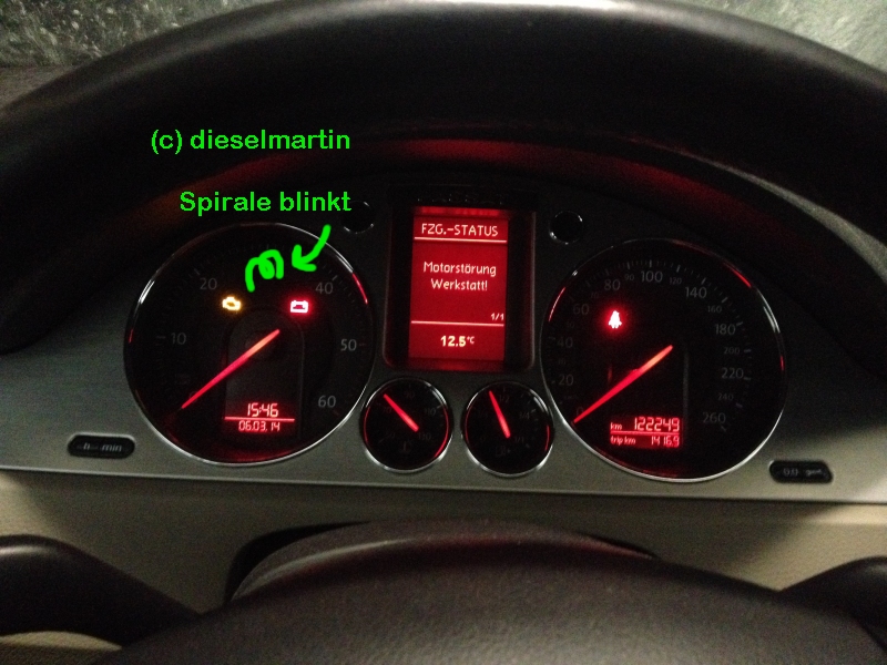

Hi.
I just drove into the car wash, and as soon as I was inside, I turned off the engine, and the instrument cluster started flashing the spiral icon.
- took a picture in the car wash.
- Ignition completely off.
- Restart ignition (no more messages).
- Drove 3 meters forward.
- Connect VCDS.
-> NO errors (except for rear fog light and air quality sensor).
I always thought that the errors the AI displays about the engine were saved.
 Engine Problems? Workshop - No Error Codes

NO.
The ELV message is likely this standard error, which also has a TPI and now a separate ELV component.
Here's the translation:
"This should only be an example to illustrate that there are occasional errors that need to be documented."
And I thought that at least one of the errors reported by the AI would be fixed.
The error that the AI presented to me today regarding the engine was so infrequent that it didn't even get logged.
Since the AI sent me to the workshop:
What would they have done?
Memory full... so either "Okay, keep going" or search for a phantom for thousands of EUR. icon_eek.gif

I can't quite piece together the exact chronological sequence of events anymore.
But you don't, for example, change the language when crossing the border, do you?
Hmpf... somehow, still icon_rolleyes.gif.
Background:
"My" key makes AI work in German.
The second key in French... more of a playful addition.
"Meinen" SchlĂźssel hat Papas G+ gefressen (es gab mal wieder nen Frontschaden in meiner Familie), der liegt gerade weit woanders, daher fahre ich gerade mitm 2. Key.
Here's how I understand the process:
- I'm going to the car wash.
- Start the engine.
- If necessary (yes, I know, this is probably the crucial point), just briefly cut the power so that the engine coasts to a stop, but the ignition is still on... possibly even within the overrun time of the MSTG.
- At the very least, the AI will appear with a blinking spiral, as shown above.
- Fully equipped in the building.
- Take out the key.
- Son called: "Bring your laptop and cables."
- At the end of the course, briefly turn right and exit onto the road for about 3 meters.
- Son coming.
- No error codes stored.
I'll try to replicate this very short engine shutdown.
It's possible that simply stopping the vehicle is enough, but the MSTG (presumably a system or organization) might "not think about it" and suddenly, for example, detect a problem with the oil pressure.
Translated on 17-10-2026, 16:20.

Thinking about it from a different angle:
When I turn off the engine in my Polo or Ibiza – preferably with a cold engine – and immediately turn the ignition back on while the engine is still stationary, a loud warning beep comes from the instrument cluster, and at the same time, the oil pressure light illuminates or flashes red. This is likely because the oil pressure sensor is still reporting pressure, but the engine speed is zero.
Could this be the trigger for you as well? Because implausible oil pressure monitoring data would certainly be a reason to have the car taken to the workshop as a precaution... ?
Translated on 17-10-2026, 16:22.

I also suspect there was some kind of communication issue between the MSG (presumably a system component) and the AI. For example, it might have been because you instructed the MSG to restart after a certain process, but it wasn't fast enough, or perhaps due to a voltage drop, for instance, caused by steering while the ignition is turned on.
I once turned off the engine while driving at 100 km/h and went around a curve. Thanks to the electric power steering, it wasn't a problem so far. Then the car slowed down, and I restarted the engine. At that moment, the steering wheel almost came out of my hands, and several warning lights and sounds appeared on the dashboard. Apparently, the voltage dropped so much due to steering and restarting the engine that the electric power steering system shut down...
Greetings.
