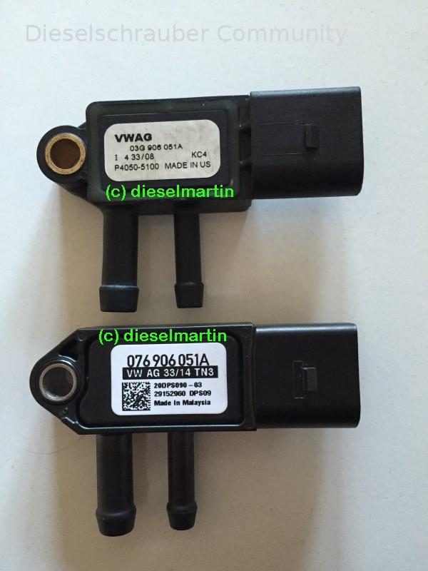

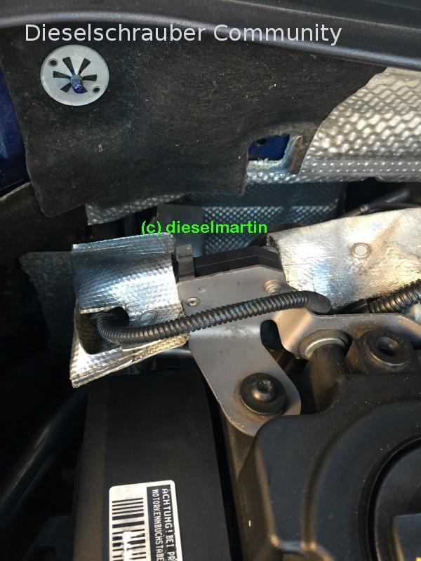

Okay.
At EUR 40, I couldn't resist.
The differential pressure sensor was installed in a rather awkward location, but it's new now.
Interestingly, it seems like it might have been replaced before, as it's dated 2008 (although my car was manufactured in December 2006/January 2007).
Code:
                Adresse 01: Motorelektronik  (03G 906 018 EM)
17:13:35 Block 067: Partikelfilter (Abgaswerte I)
  150.0°C  Temperatur vor Abgasturbolader
  63.0°C  Temperatur im Partikelfilter
  14.2 mbar  Druckdifferenz Partikelfilter
  1 mbar  Offset Differenzdruck
