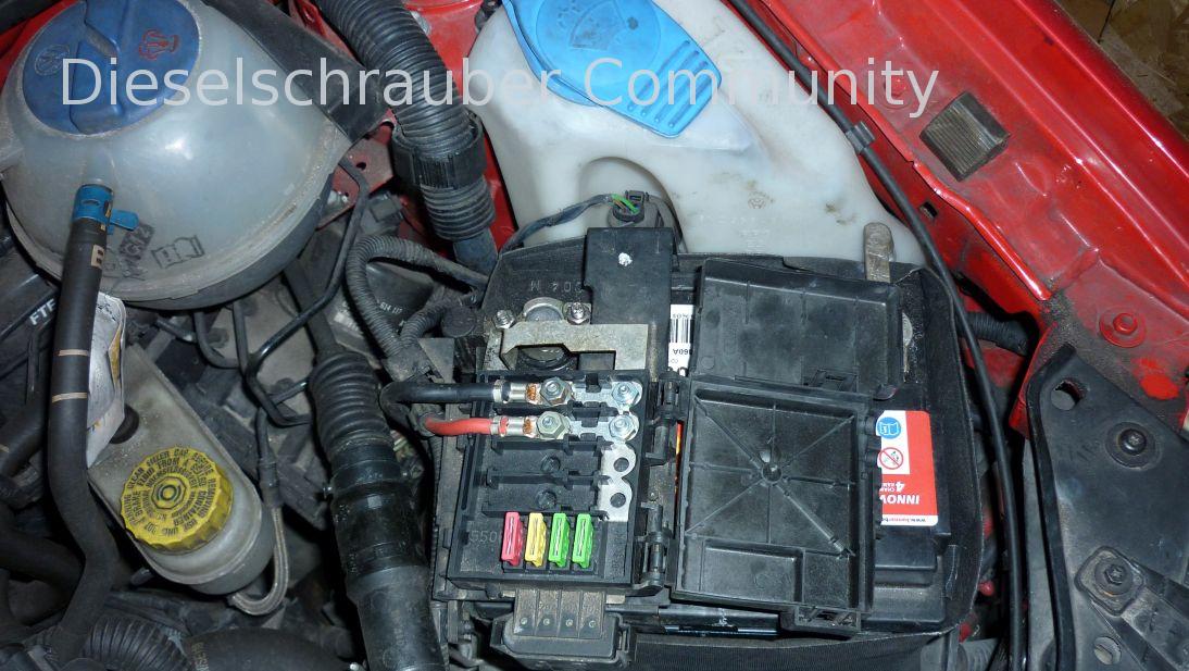

Here's a picture of the battery fuse box:
Yesterday, I quickly installed the new fuel pump and fixed the 2.8 amp error.
Best regards, Frank.

And what about the strip fuse?

Post12-05-2016, 13:13    Subject: Quote
Between the two 10mm nuts.
Wasn't the question meant to be taken seriously?
To clarify any potential discrepancies in the future, what is the official name for these fuses?

...perhaps it could also have been inquired about WHICH of the two strip fuses the 2.8A quiescent current flowed through... icon_rolleyes.gif

It was the black cable.
What are these fuses called now?

Perhaps the connections for the starter, alternator, and electrical components are marked as shown in the attached image? I've edited the image from Facebook as mentioned above.
The starter motor connector looks the same as the one on the Polo 6R. Upon closer inspection, you can see the bridge.
