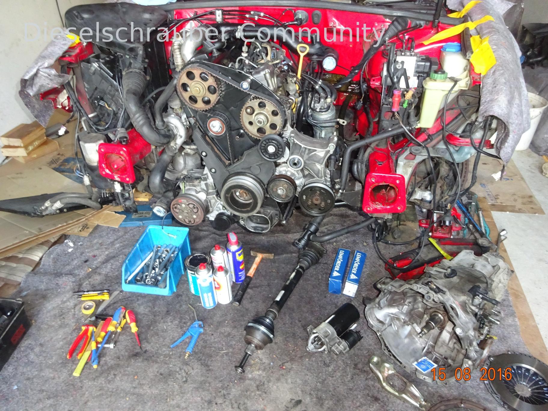

It took a little longer than expected, but it's finally here. On Friday, my Passat was brought to the 'service bay,' and then the real work began.
Here's what happened so far, and also what was planned:
- Replaced ZR (zero-pressure) valve.
- New website.
- New shaft seal EP.
- Idler pulleys for flat belts (for both LIMA and WAPU applications, as well as for air conditioning). New.
- New crankshaft oil seal (transmission side).
- Starter completely disassembled, cleaned, and lubricated.
- LIMA (alternator) completely disassembled, cleaned, new bearings, new slip rings and regulator, new freewheel.
- Power steering fluid replaced (system flushed).
- Change transmission fluid.
The following questions have arisen:

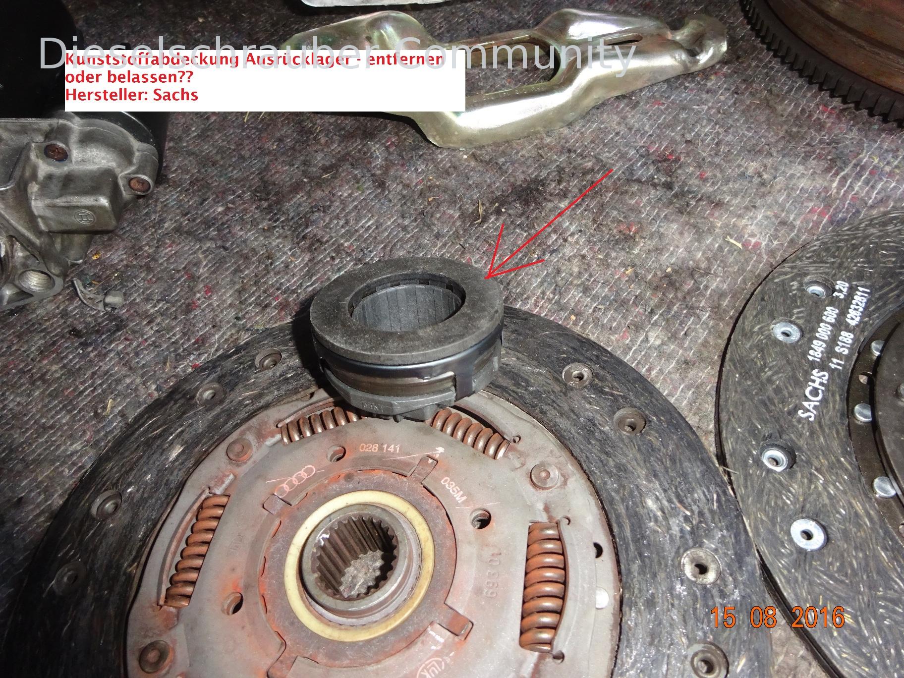

- The new release bearing has a plastic disc on the front side (the side that presses against the pressure plate springs). Should this be removed, or does it need to stay in place? The old release bearing had a metal ring in this location. The new release bearing is also slightly longer. Old bearing: LUK; the new one is a Sachs.
Please refer to the attached image for more details.
- The clutch master cylinder was heavily contaminated. - Camshaft play and free travel seem to be within acceptable limits. I obtained this data from a video by LUK.
My question: Is there any maintenance that can be performed on the ZMS (e.g., lubrication)?
- The pilot bearing was completely dry and difficult to turn. I managed to make it spin freely by using brake cleaner and special grease (Sachs). There's no noticeable play - I would leave it in place. What do you think?
'As far as I know, the bolts for the DMF (damper plate, attached to the crankshaft) are stretch bolts – I assume they need to be replaced?'
What I didn't expect:

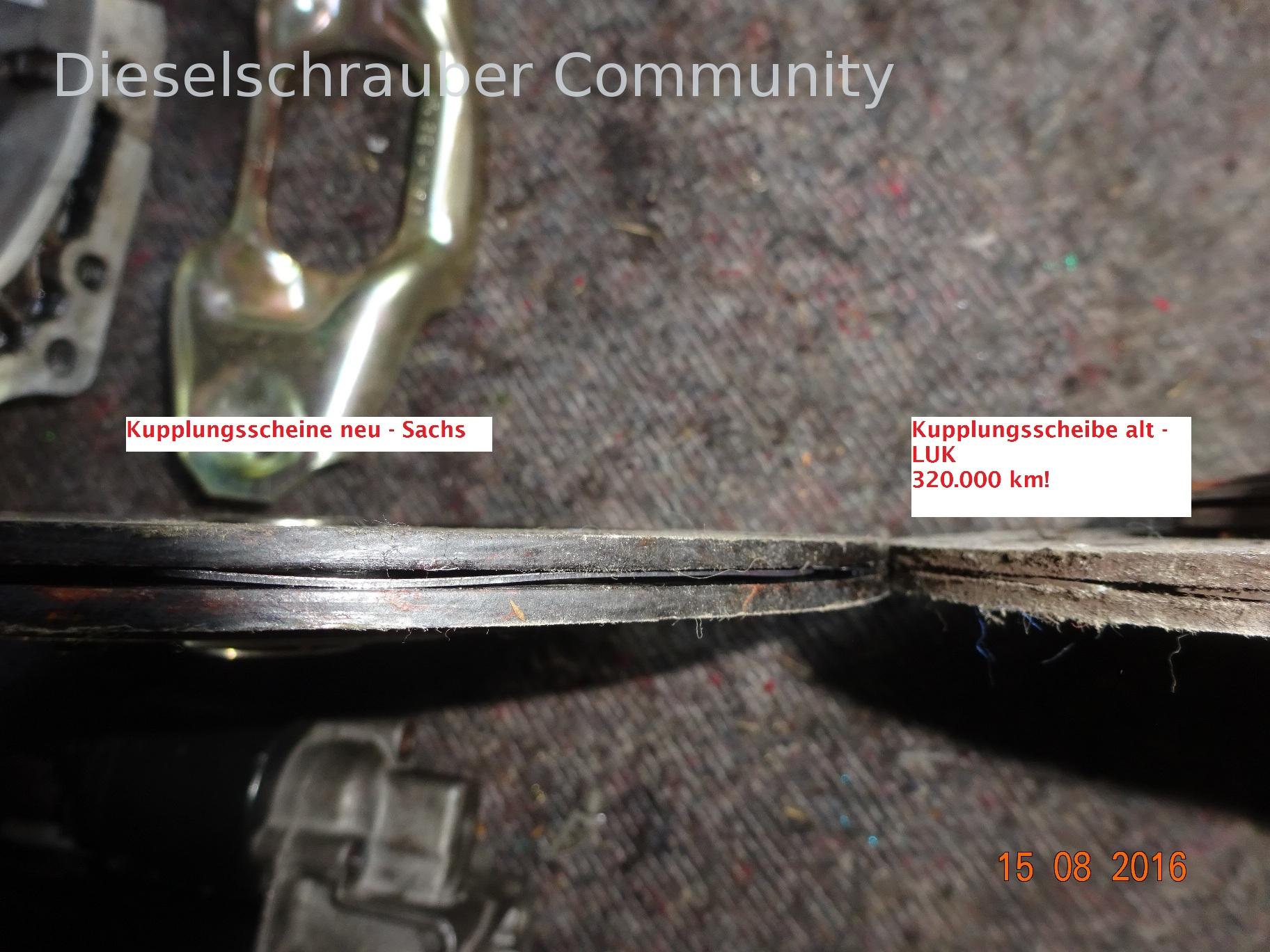

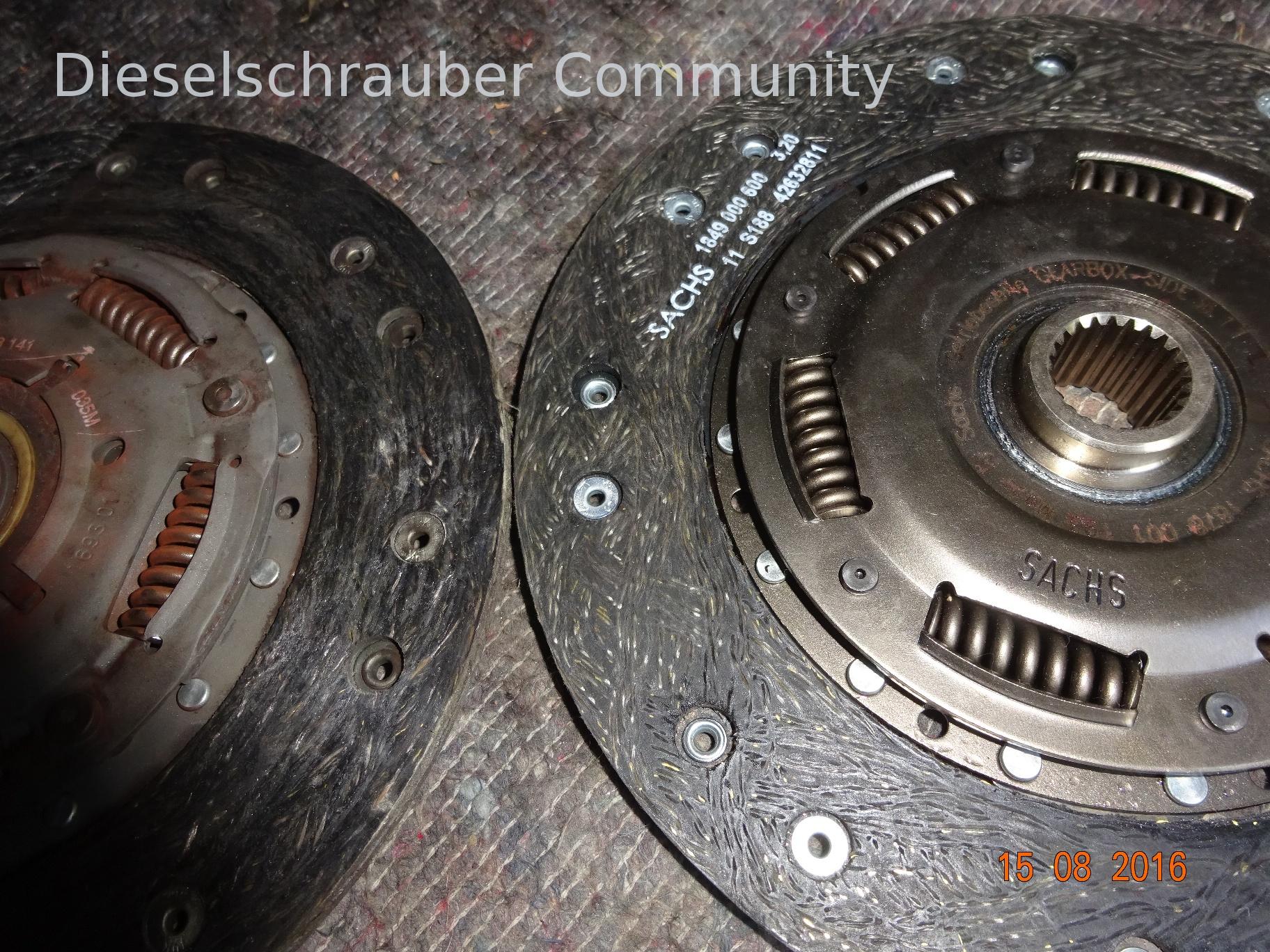

- The old clutch disc (which had never been replaced) still had a good amount of material left compared to the new one - I estimate it could have lasted another 150,000 miles. I suspect that the springs on the pressure plate are fatigued, which caused the lack of engagement. There were no signs of wear or break-in on either the old pressure plate or the dual-mass flywheel (DMF).

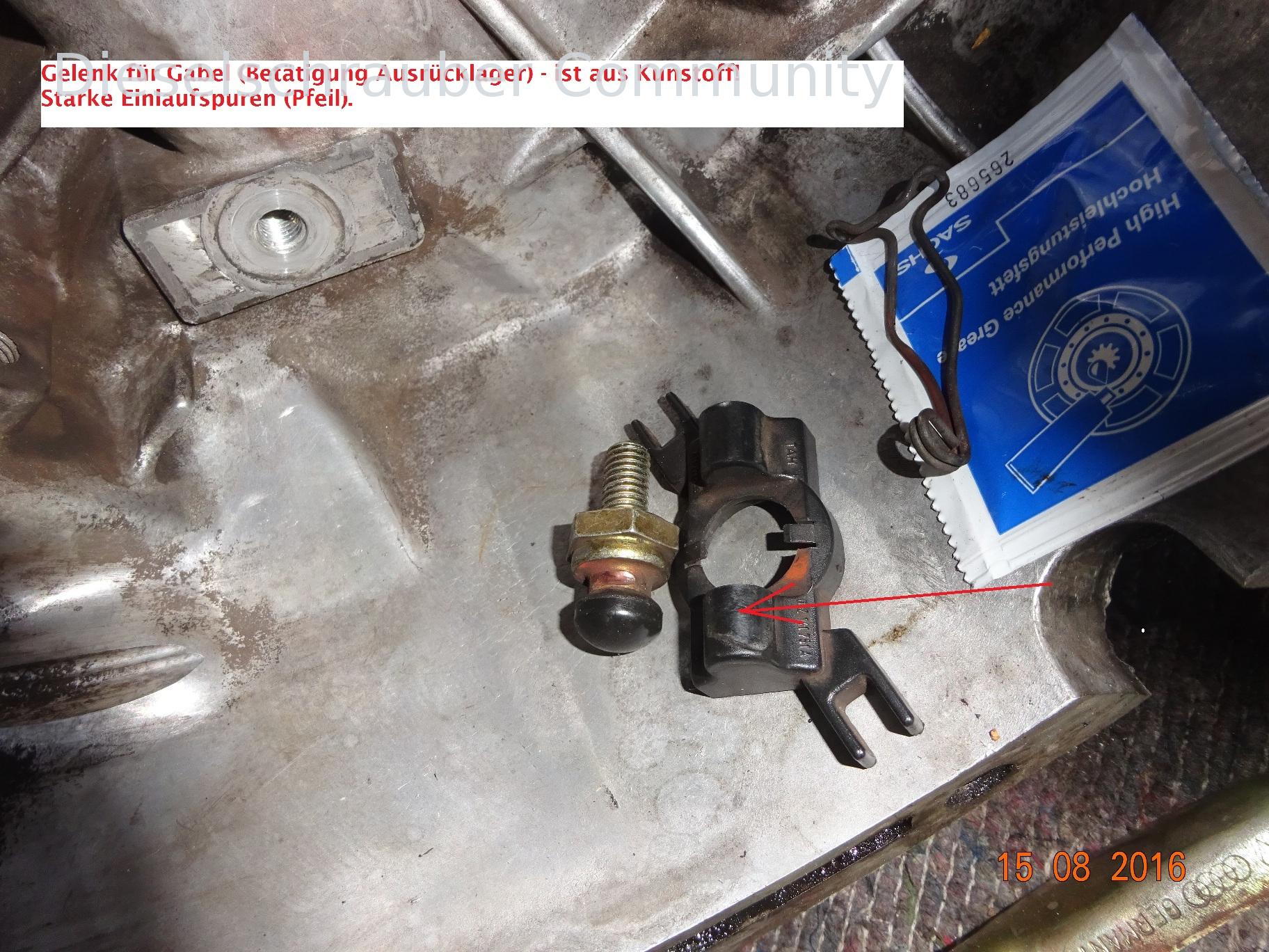

- The counterpart to the clutch release cylinder (relative to the fork) is made of plastic and shows significant wear. Consequently, the fork moves slightly further towards the transmission, and due to the uneven wear, it tilts (causing uneven loading on the release bearing).
- The bearings and gears (planetary gear) of the starter were completely dry. However, there was hardly any visible wear - and the brushes are still in good condition. I believe that the lifespan of the starter can be significantly extended by cleaning and lubricating it (this also applies to the alternator).
Added:
- Damaged halfshaft boot on the wheel side, driver's side.
- Damaged or detached tie rod end.
- Almost completely rusted connecting piece for the exhaust system.
Okay, that's all for now.
Best regards, Manuel.
