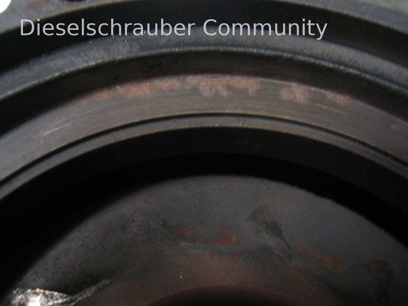

Post25-11-2016, 19:51    Subject: Quote
Hi everyone,
Okay, after the test drive with an LDA (Linear Density Analyzer) and a vacuum gauge connected to the VTG (Variable Turbine Geometry) control unit, I know for sure:
The VTG mechanism is likely stuck at the upper limit with a high gas flow rate. icon_twisted.gif
The boost pressure smoothly increases from 0.3 bar to 0.5 bar with the slightest touch of the accelerator, then returns to 0 bar when the maximum boost pressure is exceeded.
If the system is working correctly, the pressure gauge should display approximately 0.2 to 0.3 bar at maximum boost pressure.
I disassembled the ATL last night. I had to heat ALL the screws until they were red-hot before they would come loose!
Now, let's discuss the cause of the error:
Inside the open loader, I noticed that the adjustment ring is likely blocked by corrosion on the loader housing (see photo). Otherwise, I didn't find any other issues.
Can you simply sand away the rust here, or does that potentially remove a surface coating, which would then cause the corrosion to progress even faster?
I had already scraped away the area in the photo with a screwdriver. Before that, it was just small bumps.
The rest looks good and also operates smoothly thanks to the carbon film.
Best regards,
Kassen (the one with the dirty fingernails next week).
 File size:  433.02 KB
 Viewed:  1601 times
Translated on 24-07-2026, 13:26.

Post25-11-2016, 20:19    Subject: Quote
you can grind it away.

Post26-11-2016, 18:45    Subject: Best German Restaurants: Find Top Rated Dining Quote
Hey everyone,
Yesterday evening, I sanded down the rust spots, of course after removing all the soot beforehand (I really need to go get a manicure icon_wink.gif), and then reinstalled the ATL.
I just finished a test drive.
Everything is working great again! icon_smile_thumb_up.gif icon_smile_thumb_up.gif icon_smile_thumb_up.gif.
The acceleration feels noticeably smoother. Also, the automatic high beam assist (LDA) seems to be working much more effectively.
Onward to the next 170,000 kilometers...
Thank you to everyone who has supported me here. icon_thanks.gif.
VTG technology is always capable of surprising us.
The small lever definitely moved easily before. I even checked it specifically before disassembling the device.
However, when I moved the adjustment ring while it was in the open but sooty condition, it clearly rubbed against the combination of rust and soot.
My guess, since all the flaps were moving freely:
The exhaust flow must have pushed the ring (via the fins) towards the rust spots, making it impossible to reset it, even with the strong spring force of the can.
Once the exhaust flow had decreased, the can could push all the components back into their resting position.
Best regards, Kassen.
