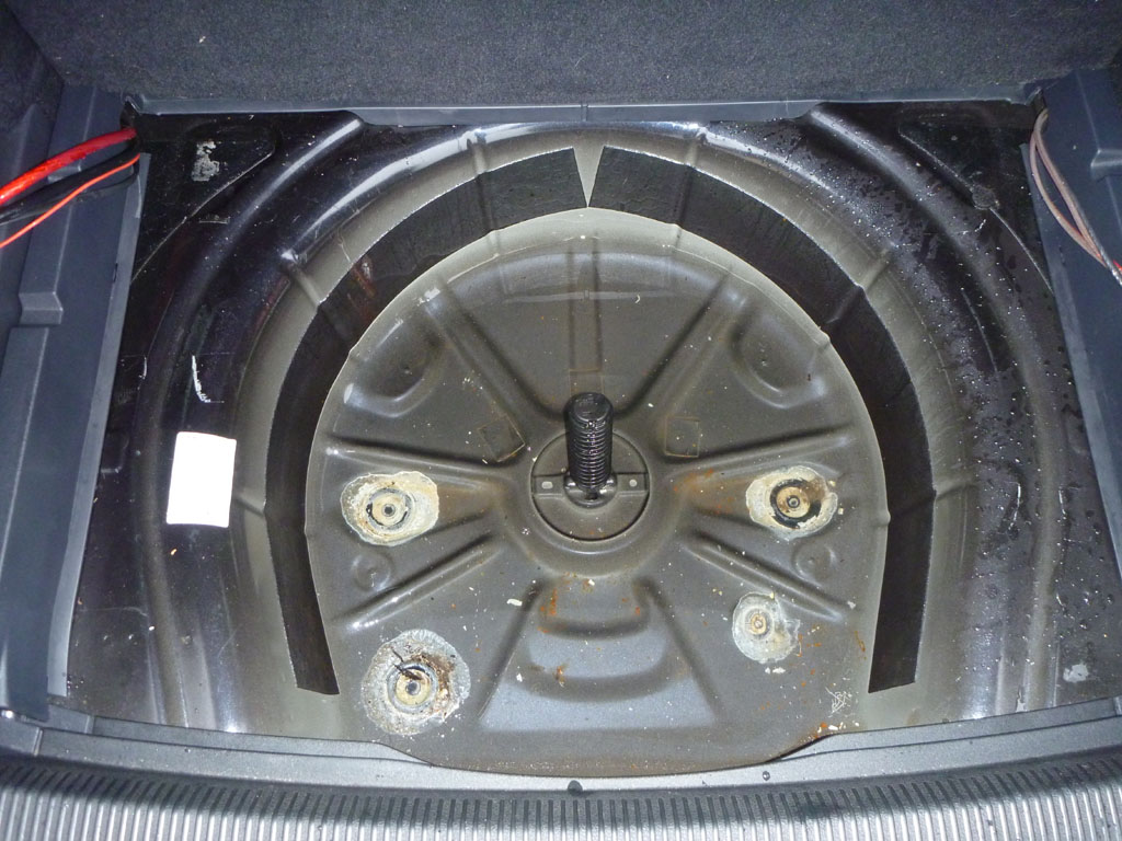

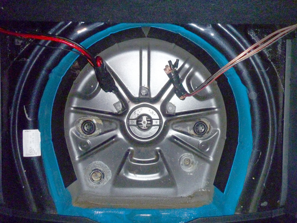

Well, now it's time to tackle some well-known issues.
Today, while changing the tires, I needed the wheel lock and found an aquarium in the spare tire well – the water level was 4 cm high.
I know that my car will have the drain tubes of the panoramic sunroof replaced free of charge if there's a problem with them (TPI number 2023456/3 from April 7, 2011). I just thought I wouldn't have such a major issue and could wait until summer to get it done.
Despite everything, I want to be on the safe side and see where it's coming from, which direction it's originating from.
The water is running into the spare tire well (which must be on the left side).
Sometimes water takes mysterious paths...
I've now applied watercolor paint and drilled holes in the drain plugs.
There's still quite a while to go until the service appointment after Christmas.

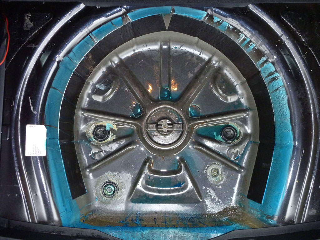

Hmm...
...I'm not exactly being particularly clever right now - which I had almost suspected already.
You can clearly see that the water is entering much more on the right side of the vehicle. Especially in the lower right corner, all the paint has been washed away. This isn't surprising, as the water tends to flow backward when starting.
The water also leaks from the groove at the top edge all around when turning.
which in turn made the entire experiment questionable.
The only thing that stands out from the attempt is that the water seems to be coming more from the right side of the vehicle.
But the rainwater drainage tubes and drain holes on the sunroof are located on the left side.
Hmm... well, all the plastic trim at the back would have to be completely removed, right down to the seat bench – everything needs to come out.
