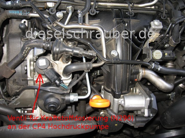

Okay, the friendly technician said that the knocking sound is normal. We compared it to a Sharan, and the mechanic heard it there too, but I didn't. We were able to pinpoint the location pretty clearly. It seems to be coming from the valve at the top of the fuel rail, specifically the uppermost electrical connection. There's a sticker with a QR code on top. Could it be that? Does this valve operate in a timed manner? How much would it cost if I paid for it myself? Please, no discussion about whether you would pay for such a repair yourself under warranty.

Post26-04-2012, 13:00    Subject: Quote
That? [Edit: N290 valve for fuel metering, labeled.]
 Bosch CP4 Hochdruckpumpe beim CFFB Motor, N290 (Ventil für Kraftstoffdosierung)

Exactly.

This is the fuel metering valve (N290) on the CP4 high-pressure pump, and I have no idea if it can be replaced so easily.
It could be used as a sound source, and it is controlled via PWM.
Tip for identification: Disconnect the connector and then check the fault memory of the relevant control unit using VCDS. icon_wink.gif

Thank you for the response. I understand that they have changed. Fuel metering valve (N290).
