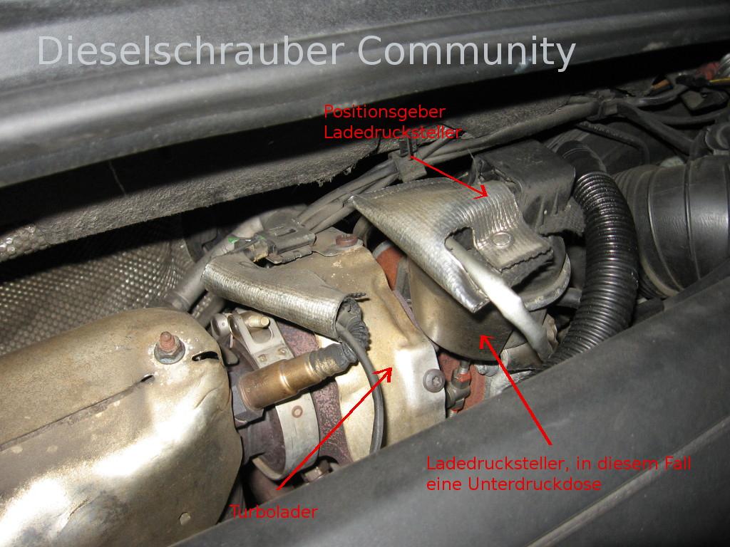

The error code P2563, "Boost pressure control valve position sensor - implausible signal," is set when the position feedback from the boost pressure control valve is not within the expected range. With our diagnostic systems HEX-NET and HEX-V2, you can easily identify this issue and conduct further troubleshooting. For other vehicle brands, we offer our OBD diagnostic system.
Possible causes:
- Faulty electrical wiring/connections to the position sensor.
- Faulty boost pressure control valve (e.g., the vacuum sensor does not hold a vacuum, or an electric actuator like those found in 3.0 V6 TDI engines is mechanically or electrically defective).
- The turbocharger's wastegate is stuck or difficult to move (the actuator cannot properly adjust the valve).
- Engine control unit (ECU) defective (due to water ingress or similar).
 Ladedrucksteller am 2.0 CR TDI CFFB

Slotti20 wrote:
Hello diesel mechanics,
I tried to reply to your article P2563, but I'm not a moderator. I wanted to add that this problem can also occur due to a fault in the vacuum system. In my case, it was a broken air connection on the vacuum actuator of the EGR valve in a T5 built in 2014 with a 2.0 TDI engine. This causes the vacuum actuator in the turbocharger control system to operate at its full range, and the sensor then reports an error. It starts with a flashing preheating indicator, followed by the engine check light illuminating.
Best regards, Slotti20
Thank you for the information! Yes, a lack of or incorrect vacuum pressure can also be caused by something else. You can use VCDS and the actuator test function to test the actuators in the vacuum system.
