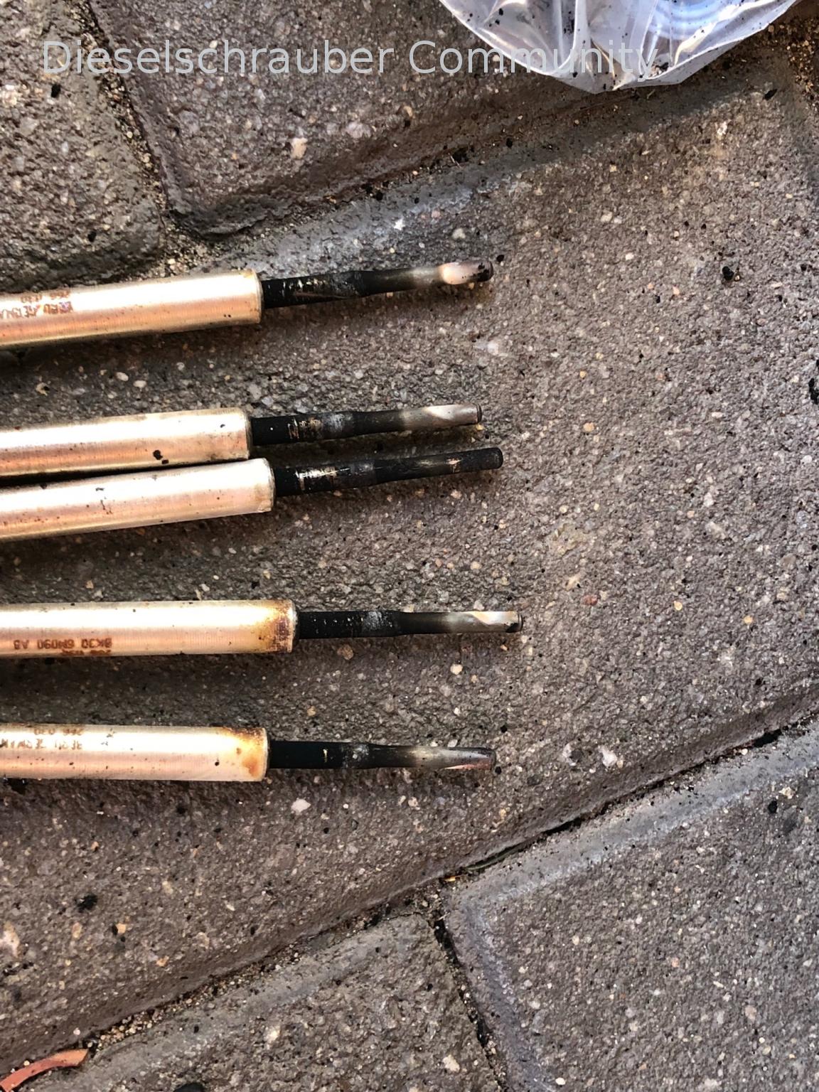

The vehicle now has approximately 107,000 kilometers on the odometer. Recently, the glow plugs were replaced because one was identified as defective. The glow plugs have an afterglow function. This at least resulted in a better start and smoother running after a cold start, even though it's currently summer.

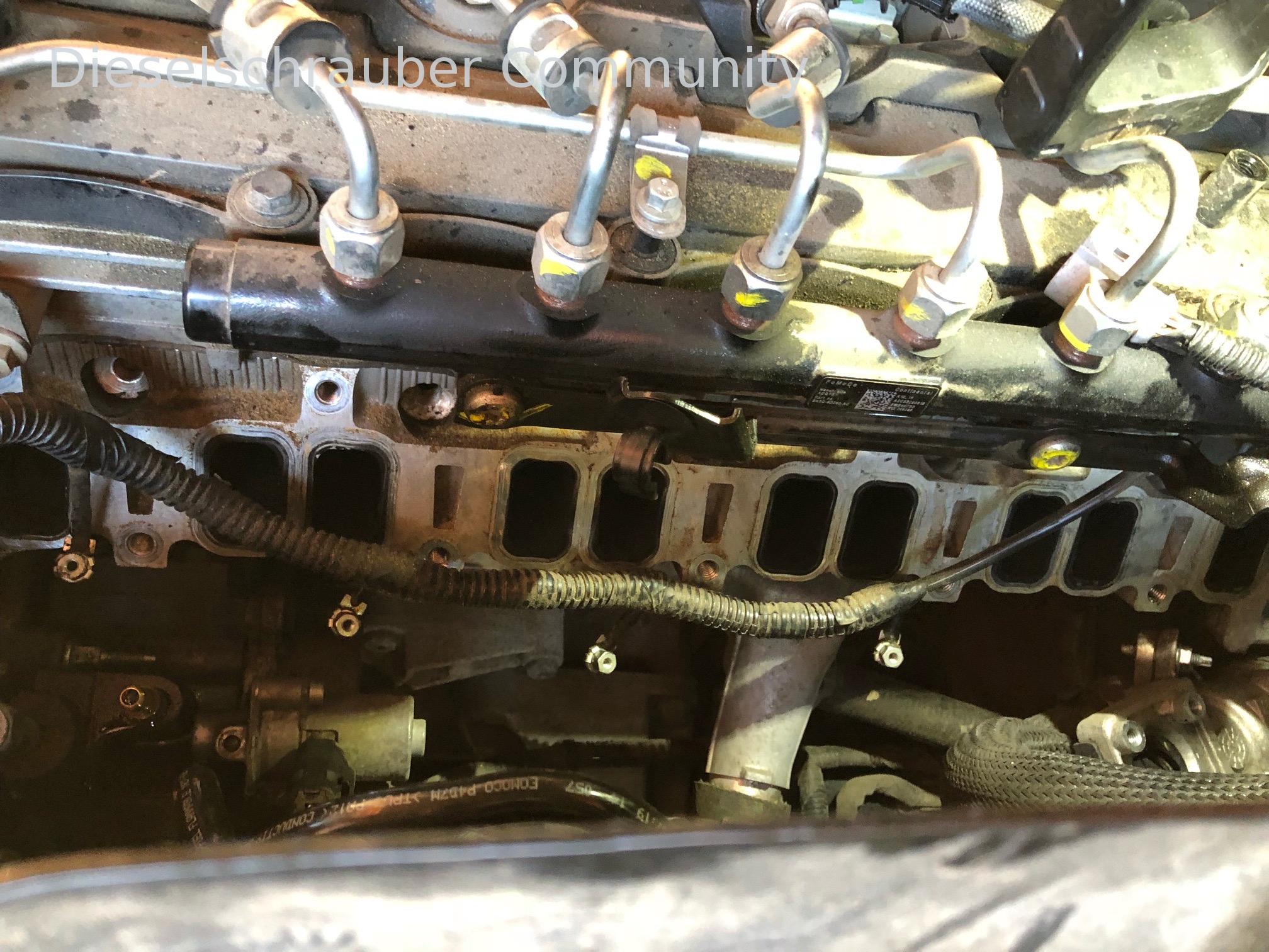

Attached is a photo of the spark plugs and the intake manifold.
 Ansaugbrücke, Rußbildung

 Ausgebaute Glühkerzen bei ca. 104000km

If I'm interpreting the article correctly, the intake manifold should probably be checked first. So, should I remove the turbo cover and at least visually inspect it?

I wonder why you can't see a "spray pattern" on a spark plug.
Even if this one is defective, it will "purge" the diesel just like the others... and after a few hours, it shouldn't be in operation anymore, and the combustion should be just as hot as with the others...

alevuz wrote:
I wonder why you can't see a "spray pattern" on a glow plug.
Because it was precisely this glow plug that was defective, and the soot on it obscures everything? icon_biggrin.gif

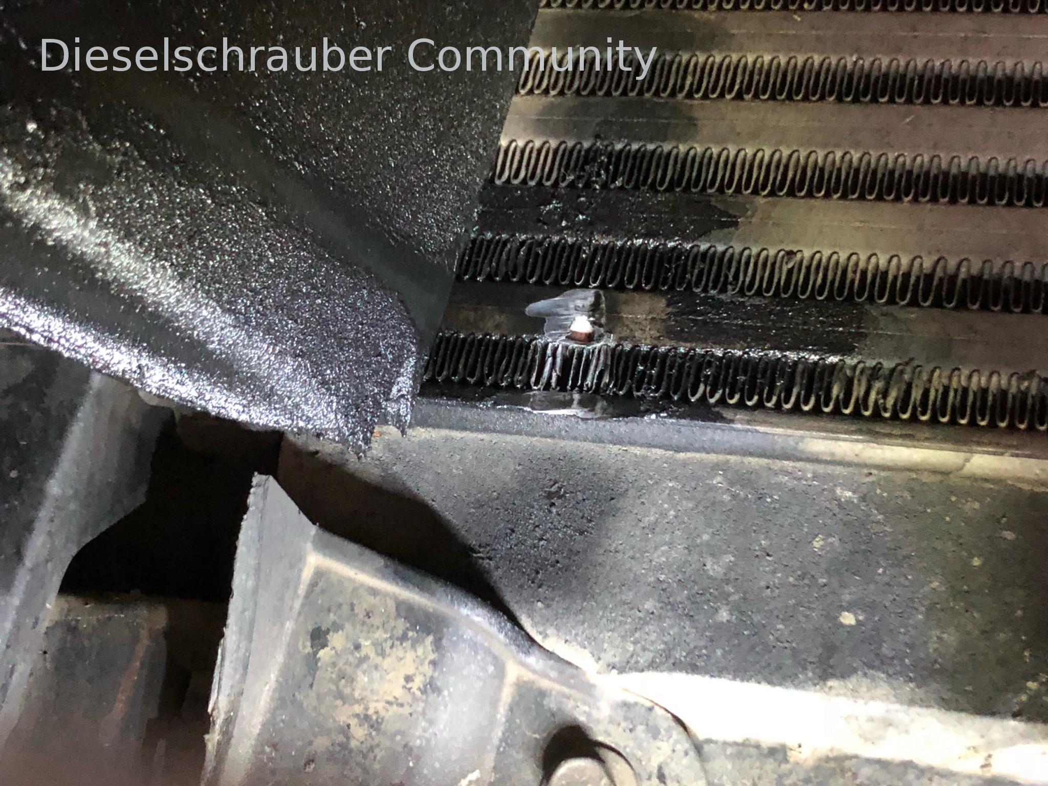

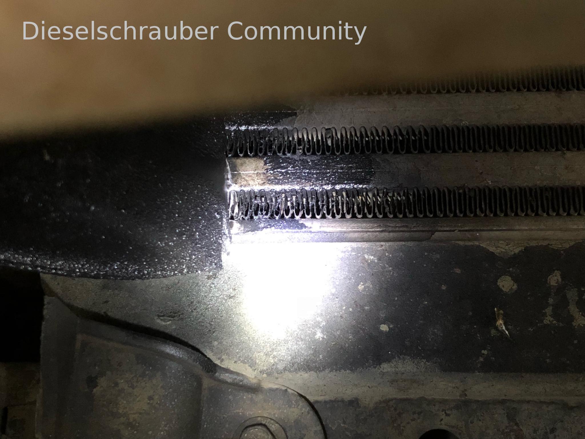

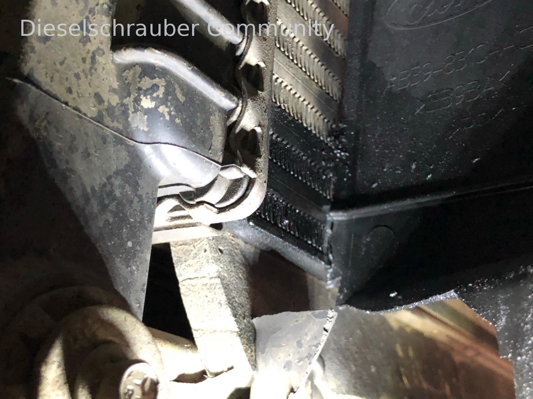

A huge hole in the LLK. I'm at least assuming that the first cooler, when viewed from the front, is the liquid cooler.
Approximately two years ago, I had a minor rear-end collision. Apparently, the expert assessor didn't notice that the plastic guide rail was broken in a way that it was rubbing against the left lower control arm. And it seems that it has now been thoroughly vetted.
And now what? I could only find one spare part in the accessories, and it's coming from England. The other LLKs seem to be tuned LLKs and cost approximately 700 euros icon_eek.gif.
Can I still drive something with this? I was planning to go to an off-road park for a meeting on Thursday.
A bandage probably won't help much.

Post31-07-2018, 22:18    Subject: Shortened DPF interval Ford Duratorq Quote
If the DPF interval is simply shortened, and if it were my car, I would definitely still make trips with minimal acceleration.
Don't forget that this also puts extra strain on the turbocharger, which is regulated to a certain boost pressure, even if some air is escaping.

Damn, unfortunately, you can't get a replacement that quickly. Initial research indicated that the cost, including installation, was approximately 600 euros for Ford vehicles.
I've been thinking about whether it would be possible to skip cleaning the area and then apply a liquid metal adhesive. And then we'll bridge the time until the favorable LLK (likely referring to a specific product or material) arrives from England.
I also need the car every day for my commute to work, and it looks like my vacation will have to be canceled unless I find a solution tomorrow.

Post01-08-2018, 9:32    Subject: Shortened DPF interval Ford Duratorq Quote
You could try sealing it with a metal-containing adhesive, but regular epoxy resin should have the same effect. The downside is that this type of material tends to soften at higher temperatures. I can't say how durable it is; attempts to "repair" a cracked exhaust manifold with something like that were not sustainable.
