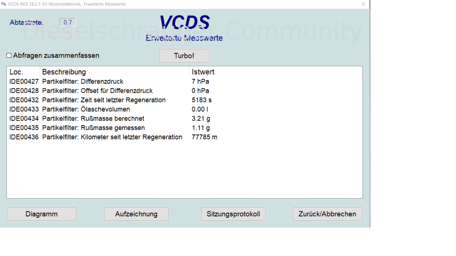

Post05-08-2018, 11:31    Subject: Reset ash mass to 0 Quote
Hello Rainer,
You are absolutely right that soot and ash are different things.
I have only used the values for black carbon mass for illustrative purposes.
My mistake.
I've already driven the car a few meters.
I also created a small log.
The oil ash volume is completely at 0.
Could it be that I reset the value to 0 by resetting the learning value of the particulate filter?
I would have expected to find a value here that could be used for writing, rather than just a point for resetting the learning rate.
Regards, Bolzer.

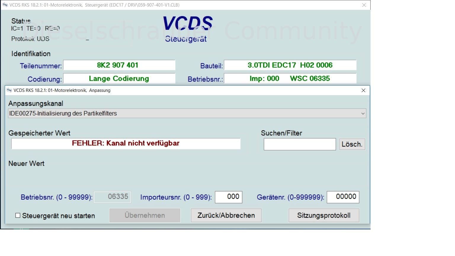

Post05-08-2018, 16:53    Subject: Reset ash mass to 0 Quote
Hello Rainer,
I went back to the vehicle and checked again.
I'm having trouble initializing the particle filter during the adaptation process; I'm getting the error message: "Error: Channel is not available."
Regards,
Bolzer.

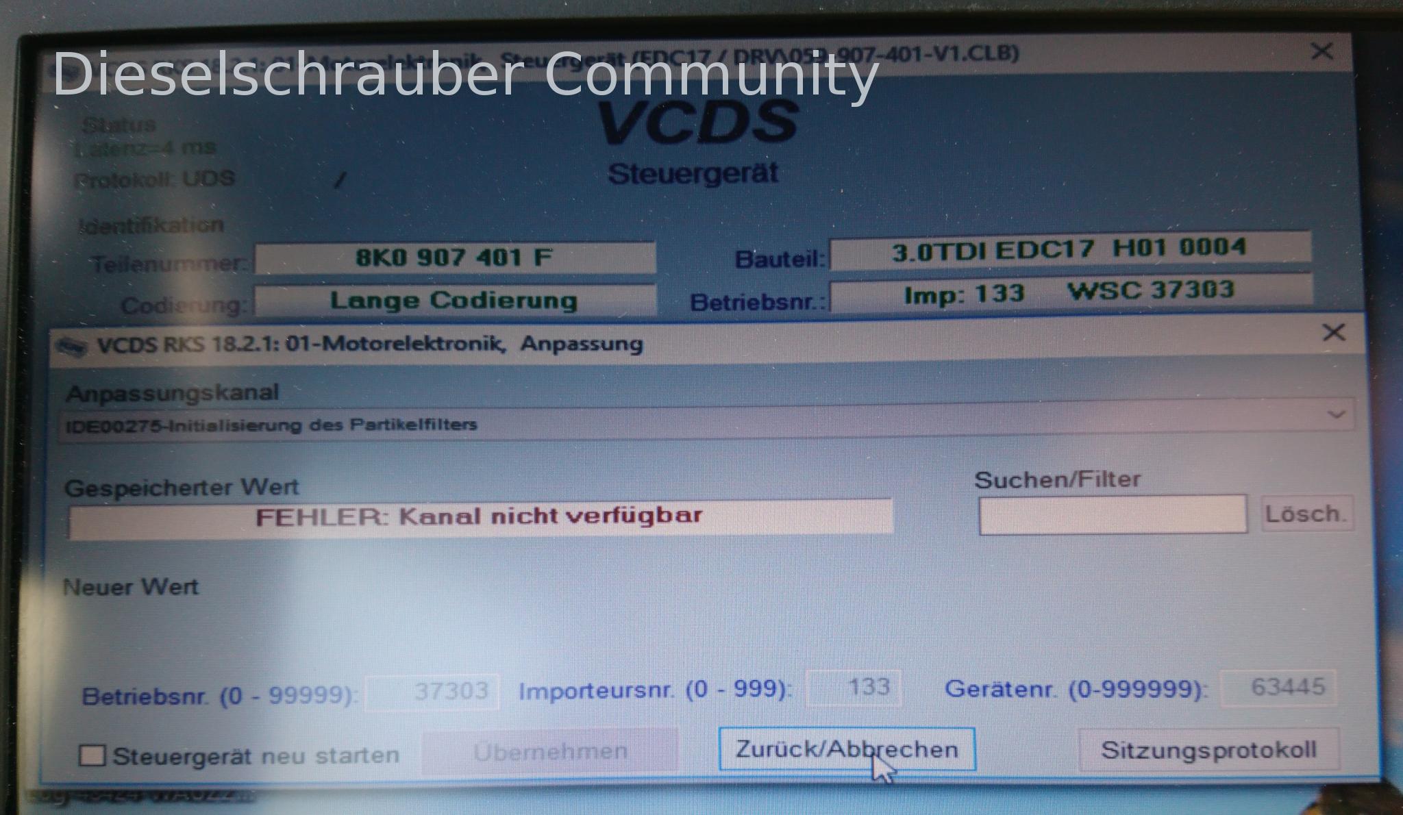

Post06-08-2018, 10:45    Subject: Reset ash mass to 0 Quote
Hey!
I'm experiencing the exact same problem. The DPF has been cleaned and reinstalled. However, the oil ash volume cannot be reset: ERROR: Channel not available. Access permission was granted on the control unit. Okay, bitte gib mir den deutschen Text und den Log, den du übersetzt haben möchtest. Ich werde dann nur die englische Übersetzung liefern.
Could it be that the faulty throttle body unit is preventing the change from being made? For testing purposes, I tried to perform a service regeneration, but unfortunately, that's not working either. Does anyone have any ideas on how we could solve this problem?

Posts: 18086
Post06-08-2018, 19:52    Subject: Reset ash mass to 0 Quote
@JeanAudi3.0TDI8KViewing profile: JeanAudi3.0TDI8K: Yes, that's quite possible. Forced regeneration with other errors = problem.
@BolzerViewing profile: Bolzer: Is your engine control unit working correctly?
