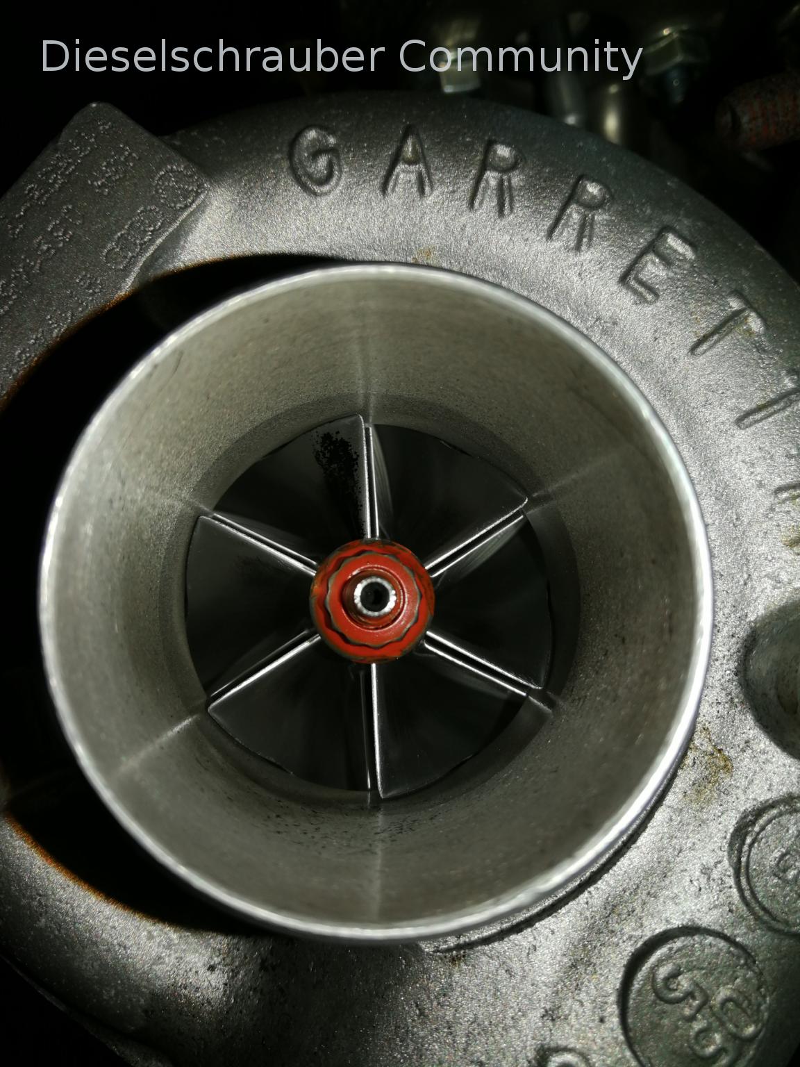

Well, I don't know what that black stuff on the compressor blades is. All I can think of is a thin layer of soot or carbon buildup. I didn't paint it on.
What exactly don't you understand?

Post06-05-2020, 19:23    Subject: Quote
I wonder about that in your case. Because the compressor wheel is usually never hot enough for oil carbon to form in significant amounts. If you're referring to a brown/black film, that's normal and doesn't require any action.
In the picture, you can see an old loader that was often subjected to high thermal loads in the past. Everything is within acceptable limits:
[img]/download.php?id=9404[/img]
Again, what's your problem?
