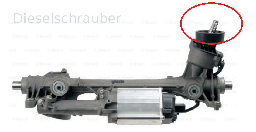

My question: Is it actually possible to replace the entire steering gear assembly yourself? The mechanical installation isn't a problem. However, I have two questions:
1.) Connect the steering shaft to the upper stub of the steering gear (marked in red). I can't determine whether there is a toothed connection or a wedge present. However, it seems logical that a precise alignment is necessary. A wedge would simplify the process. Correcting the alignment later seems impossible without disassembly. Therefore, I'm wondering what the best approach is here? Would it be sufficient to steer straight ahead and fix the steering wheel before disassembly, and then ensure that the new steering gear is, so to speak, in a straight-ahead position during installation? If there were to be any interlocking parts, I imagine that would be very difficult.

Regarding your questions.
1. Previously, the universal joint that connects the steering column and the steering gear was fitted with a pin.
2. The new steering rack needs to be adapted to the coding of the old one, and, as you already mentioned, it needs to be reprogrammed. I cannot say for sure whether the entire procedure can be completed using VCDS.

For those who might be interested: After installing a new steering rack, certain data sets (characteristic curves) need to be loaded.
Since electromechanical steering systems of a specific type are typically installed in various vehicle models, this "calibration" or "initialization" process must be performed. A VW Polo handles differently than a Sharan, although that's an exaggeration.
VCDS is not capable of doing that. Therefore, you need to visit a Volkswagen service center.
