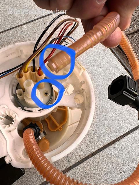

Okay, I've looked into the Sharan again to get to the bottom of this issue.
The tests for the pre-pressure and flow rate.
Everything is done with the original VW tools, specifically the VAS 6551, which is required for the testing process.
Result:
The pre-lift pump G6 achieves a pressure of 4.5 bar, but the amount of fuel that should flow into the measuring cup within the 30-second activation time is completely incorrect.
There were only 100 ml in the measuring cup.
Okay, so let's remove the tank and take a really close look at the pumping unit.
When removing the pump unit, the plastic pipes for the suction pump, supply, and return lines must be disconnected from the quick couplings inside the tank in order to extract the unit from the tank.
During this job, I was already holding the pipe connecting the pump to the hose when I noticed that the fitting on the pump had broken off.
It was clear – there was nothing to fix or repair; a new blower unit was needed.
Okay, so I need to get the parts, install them, and then take it for a test drive.
Okay, I did what was needed, and the car is running again. The problem hasn't reappeared so far, even though I've tested the problematic RPM range multiple times.
What I noticed later was that when I was bleeding the fuel system, I could only hear the faint hum of the pump in the tank. Before, it was louder and accompanied by a distinct splashing sound.
My assumption is that the connection fitting between the booster pump and the suction pump, which pumps the fuel into the reservoir, was already cracked.
