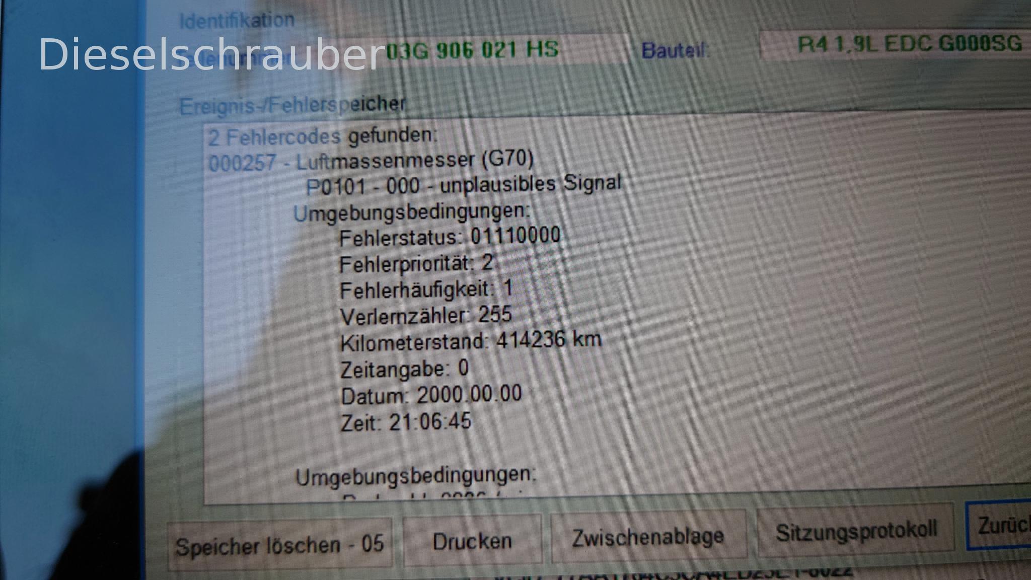

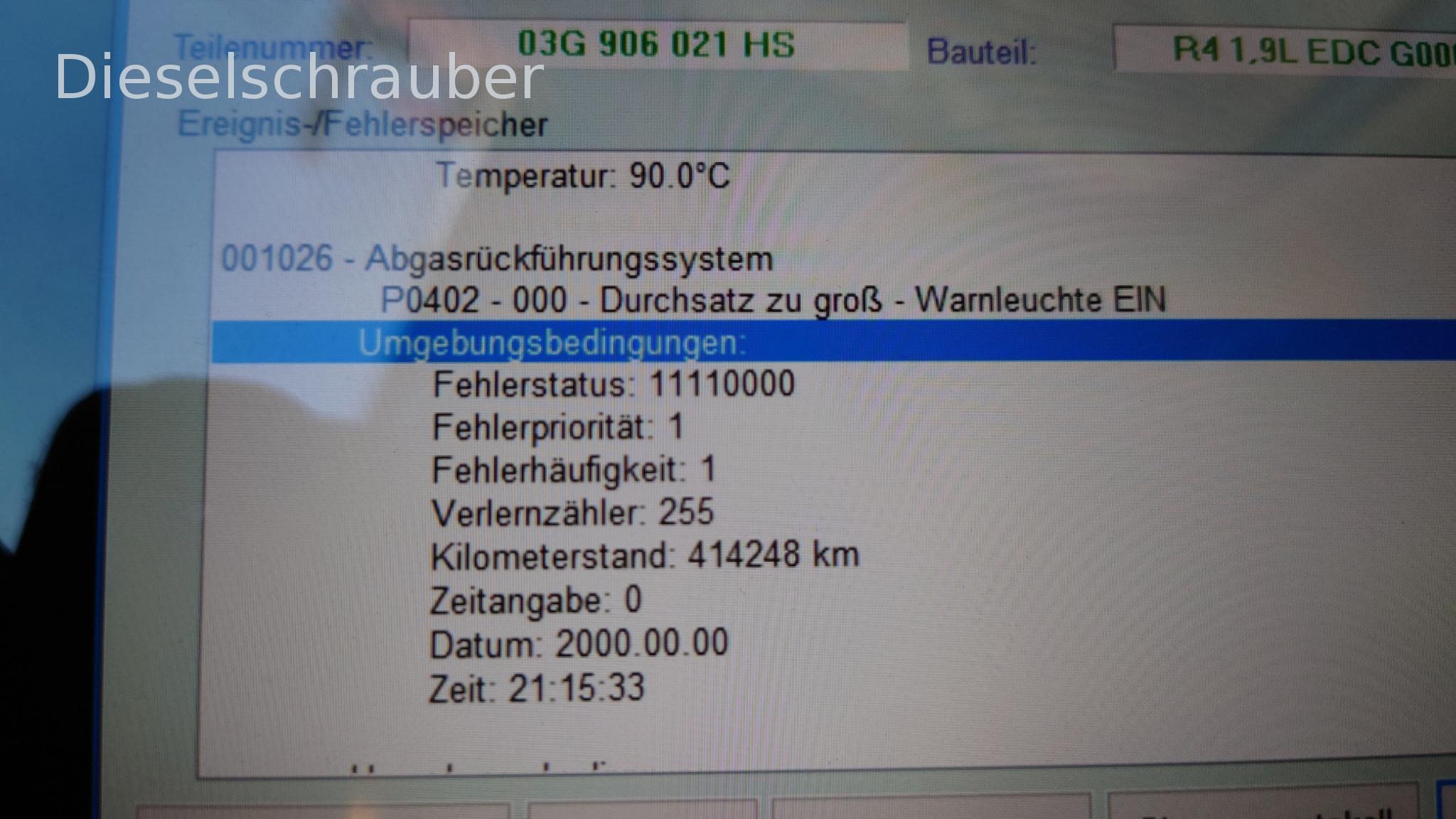

"When driving with a warm engine at a constant speed with very little throttle, the EGR error 'P0402 - 000 - Throughput too high - Warning light ON' occasionally appears."
When I restart the engine, I also get the error code from the mass airflow sensor: "P0101 - 000 - implausible signal."

What I find particularly noticeable are the target and actual values of the EGR (Exhaust Gas Recirculation) system.
 Fehlercode P0402 Luftmassenmesser
 Fehlercode P0101 AGR
