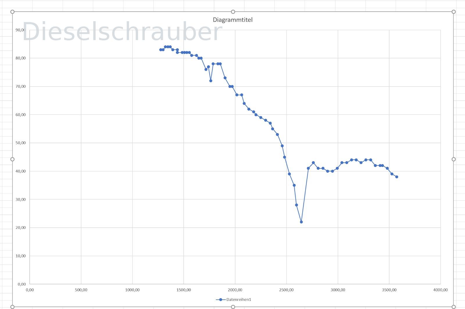

Post08-06-2024, 16:13    Subject: Quote
Hello everyone,
I finally had some time again and was able to put the tips into practice.
I switched the turbocharger back again. While doing so, I noticed that the pipe between the turbocharger outlet and the EGR valve was broken! I have no idea how I could have missed that last time. I even looked at it specifically. However, it's sealed again now.
I also shortened the connecting rod by exactly one rotation, as suggested. After assembly, the car is now "driveable." Definitely much better. Of course, I don't know for sure whether the improvement was primarily due to the leak being fixed or to the adjustment of the tie rod.
Unfortunately, I didn't have a tester available to log the results. However, there was a noticeable increase in torque that could be felt starting at 2000 RPM.
I then, as a test, shortened the tie rod by another full rotation, but nothing noticeably changed. Attached is the log from the version with the tie rod shortened by two rotations. You can now see a clear overshoot.
I would now turn the rod back one more revolution and test it again.
What the logs now show (and what is also felt in reality) is that not much happens below 2000 RPM.
But, as I said, purely in terms of performance, the vehicle is now significantly more powerful and responsive.
Attached is a Screenshot of the log.
The boost pressure should be significantly higher than 2000, right? Is that correct? Where else could I make adjustments?
Looking at the N75, it seems to operate at around 80% at just under 2000 RPM. Doesn't it open up to 100%? Then, according to my understanding, the EGR adjustment would be somewhat more aggressive, wouldn't it?
Best, Al.

Post08-06-2024, 17:05    Subject: Quote
Thank you for the feedback. But two negative things at once.
I switched the turbocharger back to the original one again.
It was never requested. If you have a new one, then just leave it in.
I said *one* revolution, and I emphasized "one" because if the overspeed is too high, the turbine shaft can break off from the compressor. Boom, broken, engine failure.
"At least you checked how the wastegate looks; as expected, it's too high, and I suspect the old (carbonized) turbocharger has been reinstalled, which seems to be causing the VTG (variable turbine geometry) to jam. The boost pressure drops almost abruptly from 2500 mbar to 2000 mbar. The target boost pressure at 2000 rpm is still not being reached."
I noticed that the pipe between the turbocharger connection and the EGR valve was broken! I have no idea how I could have missed that last time.
Yes, I have no idea. Usually, you don't even need to see it, because you can already hear the loud hissing sound when you accelerate.
Translated on 10-10-2026, 5:00.
