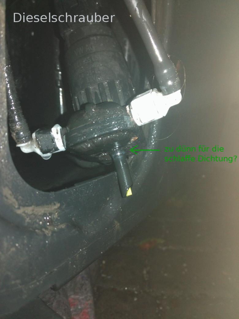

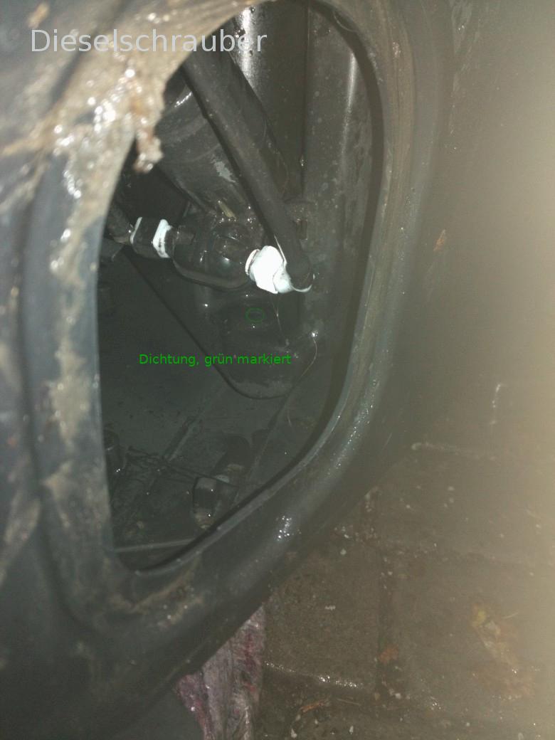

Today, I found that the water tank in my T6 was empty, even though I had filled it just last weekend.
While searching for the cause, I noticed the inserted pump. The seal that fits into the suction tube seems a bit loose, and directly underneath, where the hoses connect to the pump, there was a drop of water.
As a quick fix, dry the suction nozzle of the pump thoroughly and then wrap it with 2 layers of insulating tape to slightly increase the diameter. Now sits tighter in the rhyme, whether it rhymes, the days will show.
To access the windshield washer pump, you don't need to remove anything major. A valve in the left front fender well can be opened with a large screwdriver.
Best regards, Rainer

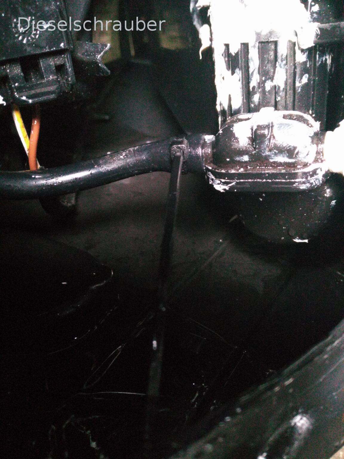

After partial filling with wash water concentrate, the only blue drops I could find were directly at the pump's hose connection. There was quite a bit of dripping.

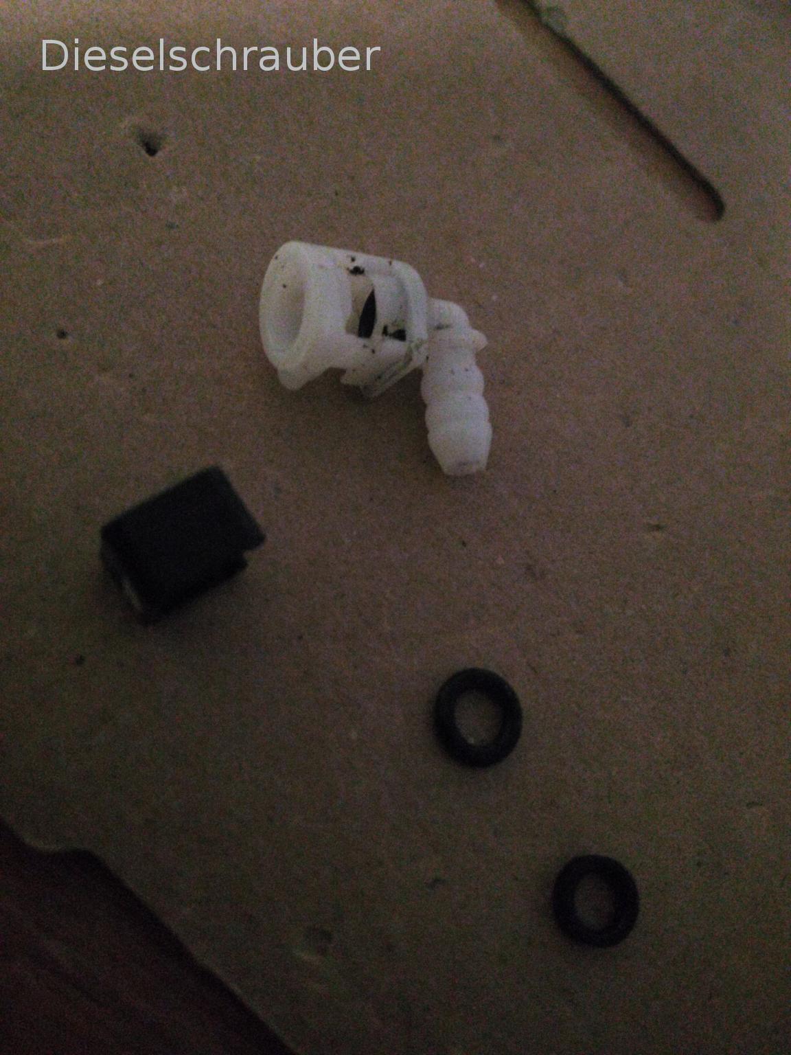

The gasket in the fitting appeared slightly compressed in one area, and my first attempt was to replace it.
After about 15 minutes of fiddling with a paperclip and various O-rings, I, frustrated, decided to simply insert a piece of silicone tubing directly into the pump nipple and the cut-off spray hose. Secured with cable ties, just to be safe. Now, no more drops can be seen.
Therefore, I am confident that it really works, whether it does or not will become clear in the next few days. icon_lol.gif
