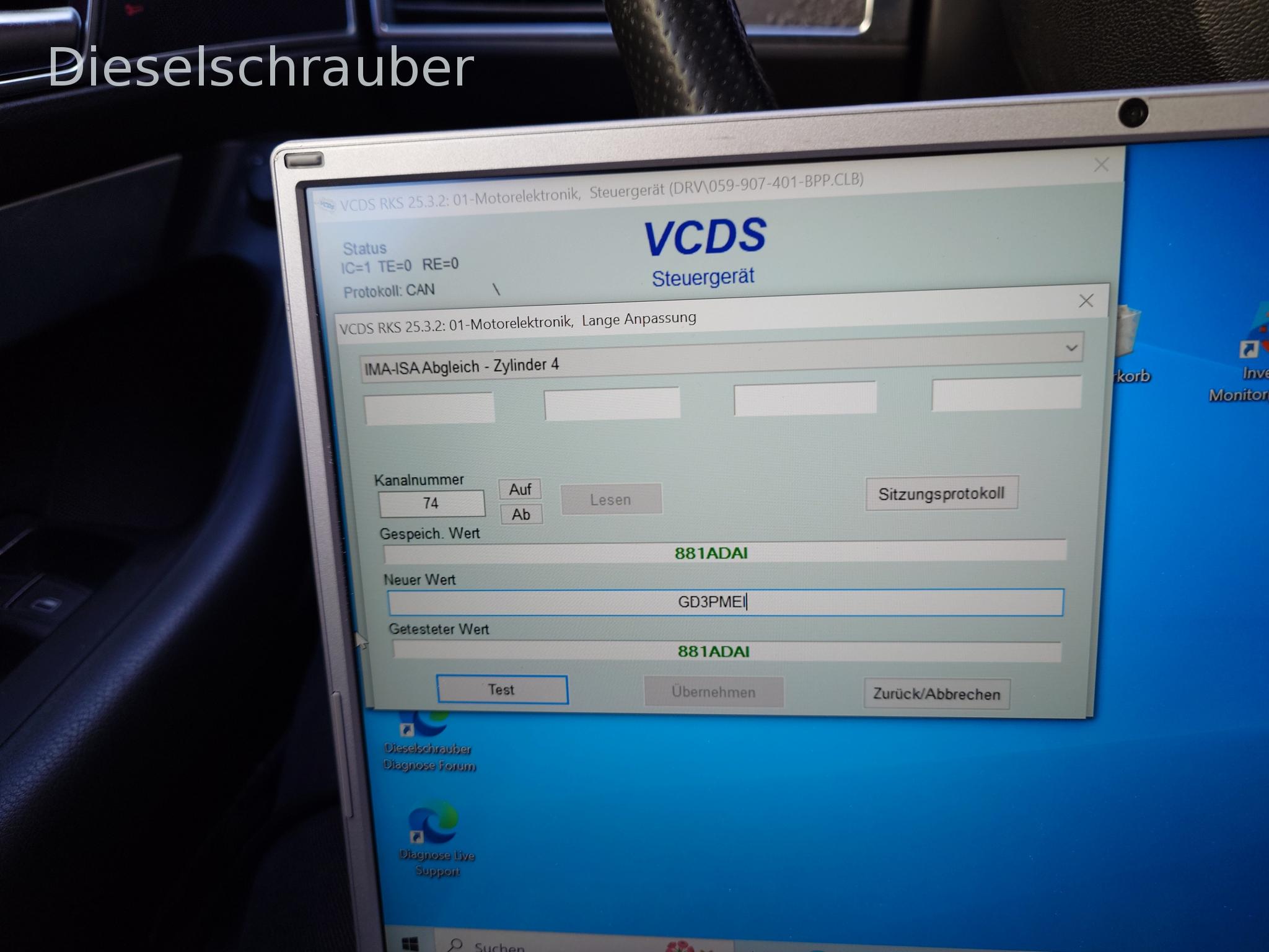

Hi there,
I had new injectors installed in my BPP vehicle after quite a few kilometers. (Okay, not entirely new, but refurbished with a testing report.)
The exchange involves entering the new IMA ISA values via the extended configuration settings.
My VCDS or control module doesn't accept it. When I try to test the new value, it always shows the original value as being tested.
If I enter a code that is too short, I receive an appropriate error message.
What am I doing wrong?

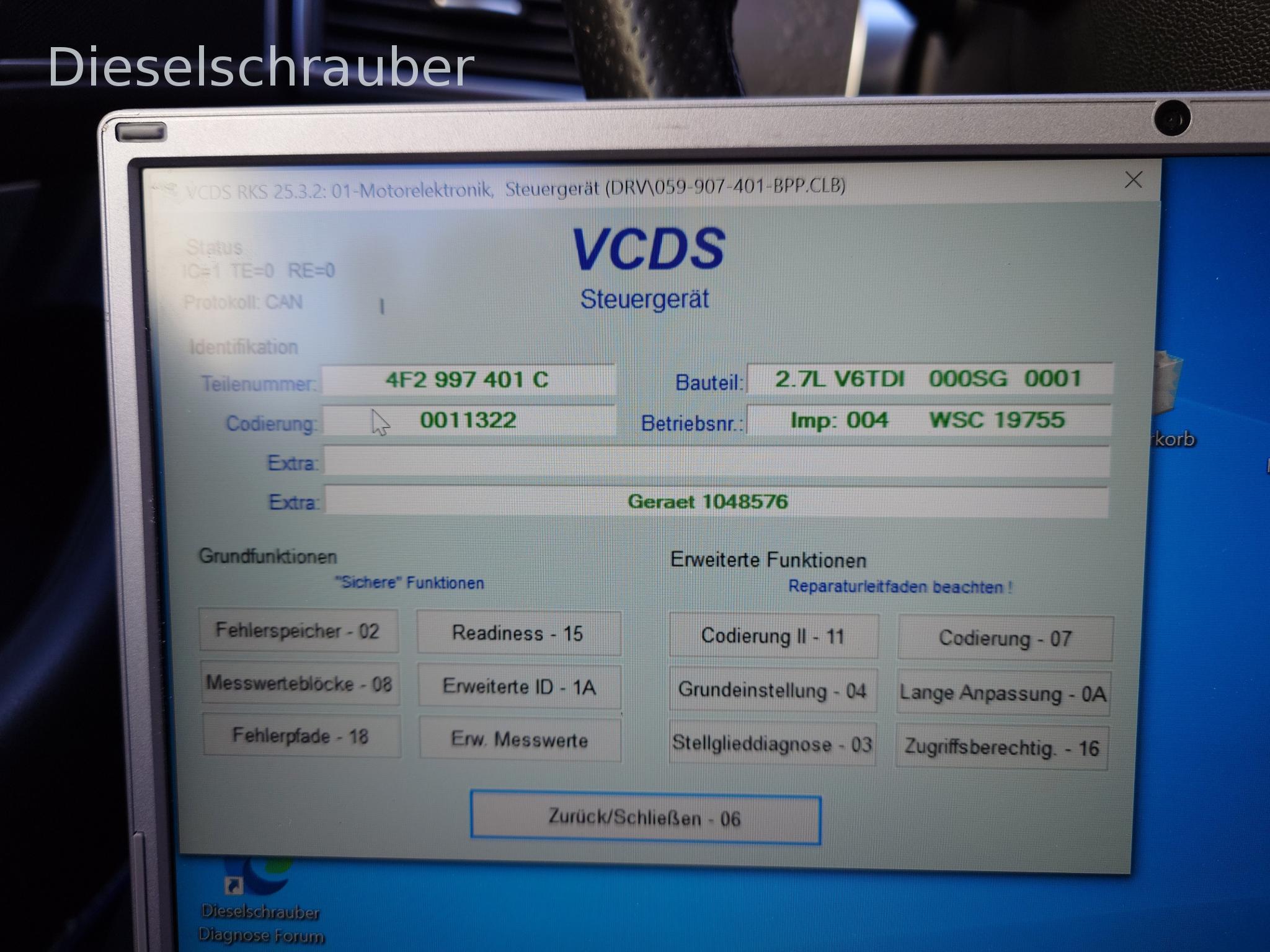

It's different for me.
Extended adaptation, oA, instead of 10.
Gruß Christian
Translated on 31-07-2026, 14:36.

Post28-04-2026, 16:59    Subject: Injector Calibration: How to Calibrate Injectors Quote
Long adaptation, oA instead of 10.
And then, after I pressed the "Test" button.
 File size:  2.34 MB
 Viewed:  211 times
 File size:  4.27 MB
 Viewed:  205 times
Gruß Christian

Post29-04-2026, 5:05    Subject: Injector Calibration: How to Calibrate Injectors Quote
Hi there,
Could it be that with this message (MSG), the new Instantaneous Maximum Acceleration (IMA) value is only displayed and recorded after an ignition on/off cycle, with a few seconds of waiting time?
It's not like that for me, see here https://community.dieselschrauber.org/en/viewtopic.php?t=30733&highlight=ima.
But who knows?
Perhaps a login is also required for the MSG?
Translated on 31-07-2026, 14:38.

Post29-04-2026, 20:29    Subject: Injector Calibration: How to Calibrate Injectors Quote
So, it seems the situation is quite different than we thought.
Two of the six nozzles are assumed to have certain codes, while the others do not.
I have no idea what the detailer did wrong.
Anyway, they're coming back.
Gruß Christian

Post29-04-2026, 21:01    Subject: Injector Calibration: How to Calibrate Injectors Quote
Hi there.
You are using the IMA codes that come with the documents, not the embossed ones.
I would consider all of these injectors to be unreliable (and not even one of them during a warranty replacement).
Were the old injectors that bad? And if so, are there any replacement injectors available from Audi or Bosch (or Delphi)? They would probably cost more, but they might be more reliable.
I'm surprised that when incorrect IMA codes are used, a "AAAAA..." sequence isn't output as a test result.
Translated on 31-07-2026, 14:40.

Post03-05-2026, 17:20    Subject: Injector Calibration: How to Calibrate Injectors Quote
Yes, they are all being returned.
They call them "refurbished," but I can't see that anything was actually done to them besides cleaning.
Two protocols even show a result of "Failed."
Gruß Christian
