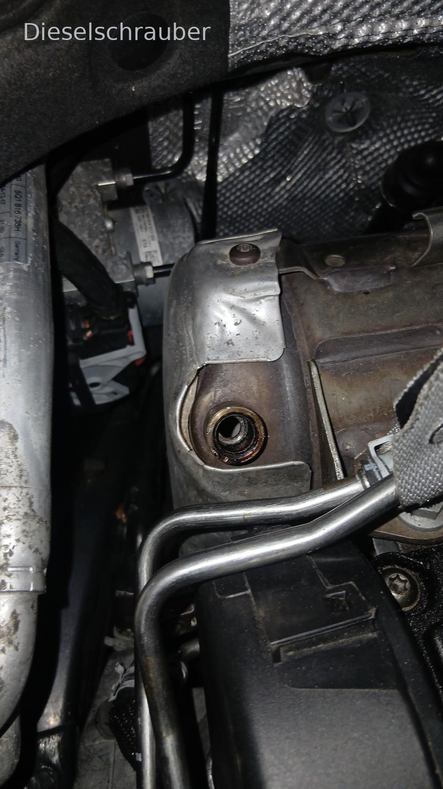

That was the sensor located above the timing belt cover, and it showed me a difference of 500 degrees at full load.
Okay, so Temp1 was at 700 degrees and Temp3 was at 200 degrees. Yesterday, the connector was loose, and then the values jumped. However, the error memory was completely empty.
I've reordered it now. I will install it and then initiate a single emergency regeneration cycle, after which I will drive it and compare the actual values.
