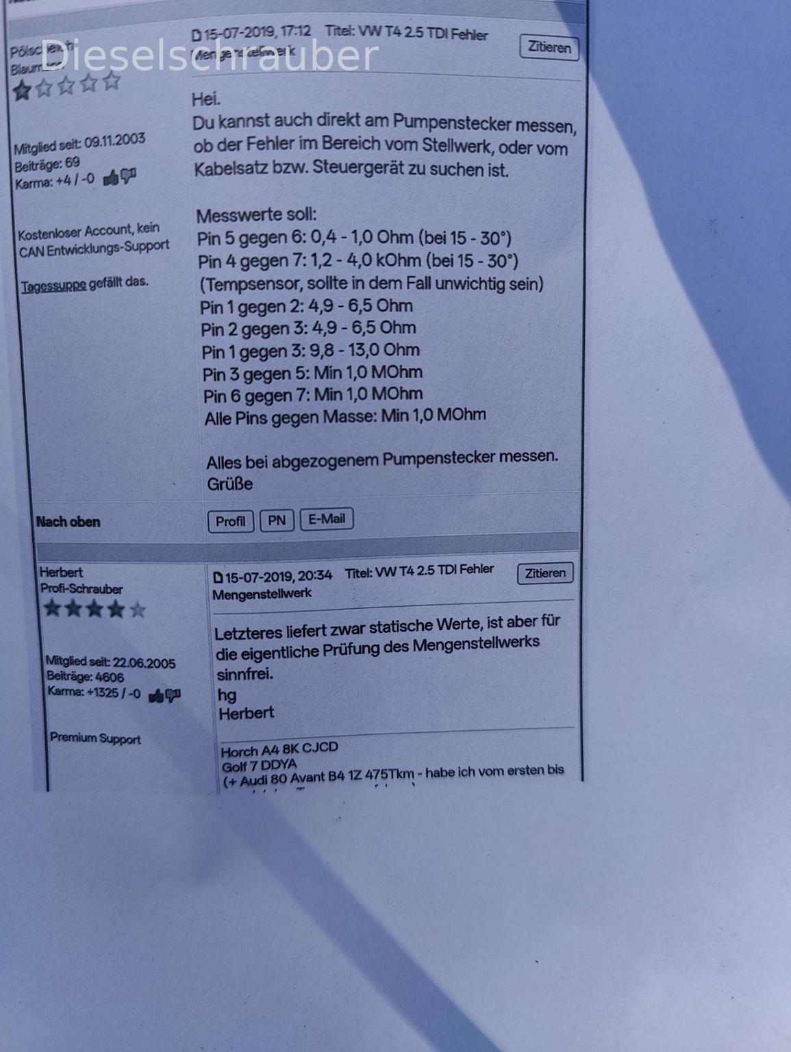

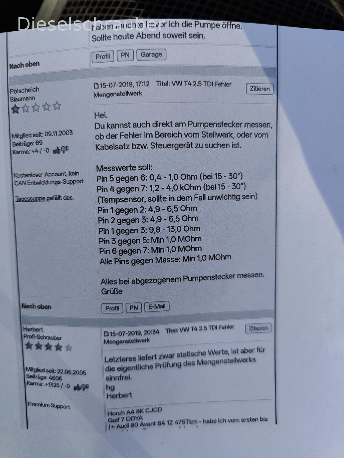

Post12-08-2026, 15:05    Subject: T4 AJT ESP Issues: Troubleshooting & Solutions Quote
Okay, all the measurements are within acceptable limits except between values of 3 and 5, or 6 and 7, where there is no resistance detected.

"Someone is objecting to the automatic scanning."
Does "no resistance" mean a measured value of R = infinity or R = 0?

Post12-08-2026, 15:23    Subject: T4 AJT ESP Issues: Troubleshooting & Solutions Quote
In my case, "no resistance" means an infinitely high resistance.

Post12-08-2026, 16:08    Subject: T4 AJT ESP Issues: Troubleshooting & Solutions Quote
You're reading at least 1 MΩ up there, right?
