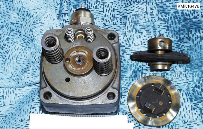

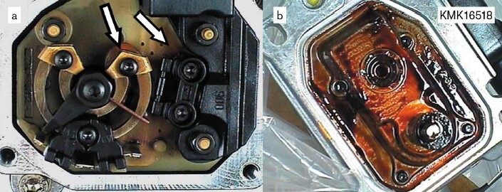

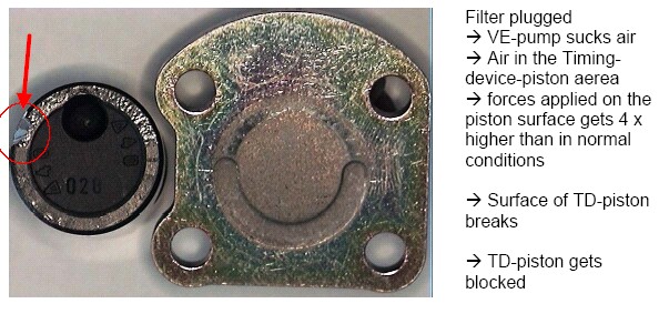

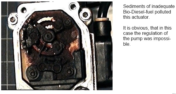

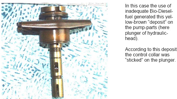

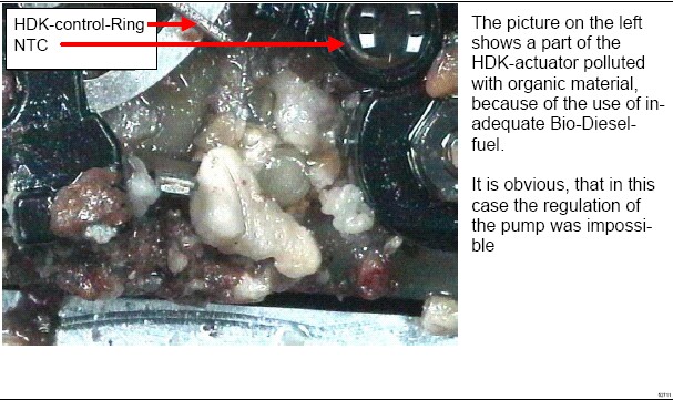

Here are some pictures for the fairy tale book:
 File size:  59.25 KB
 Viewed:  3743 times
 File size:  51.9 KB
 Viewed:  3855 times
 File size:  65.11 KB
 Viewed:  3723 times
 File size:  68.85 KB
 Viewed:  3744 times
 Oxydation und Ablagerungen im Stellwerk
 File size:  78.25 KB
 Viewed:  3812 times
 Ablagerungen an der Hubscheibe
 File size:  118.2 KB
 Viewed:  6696 times
