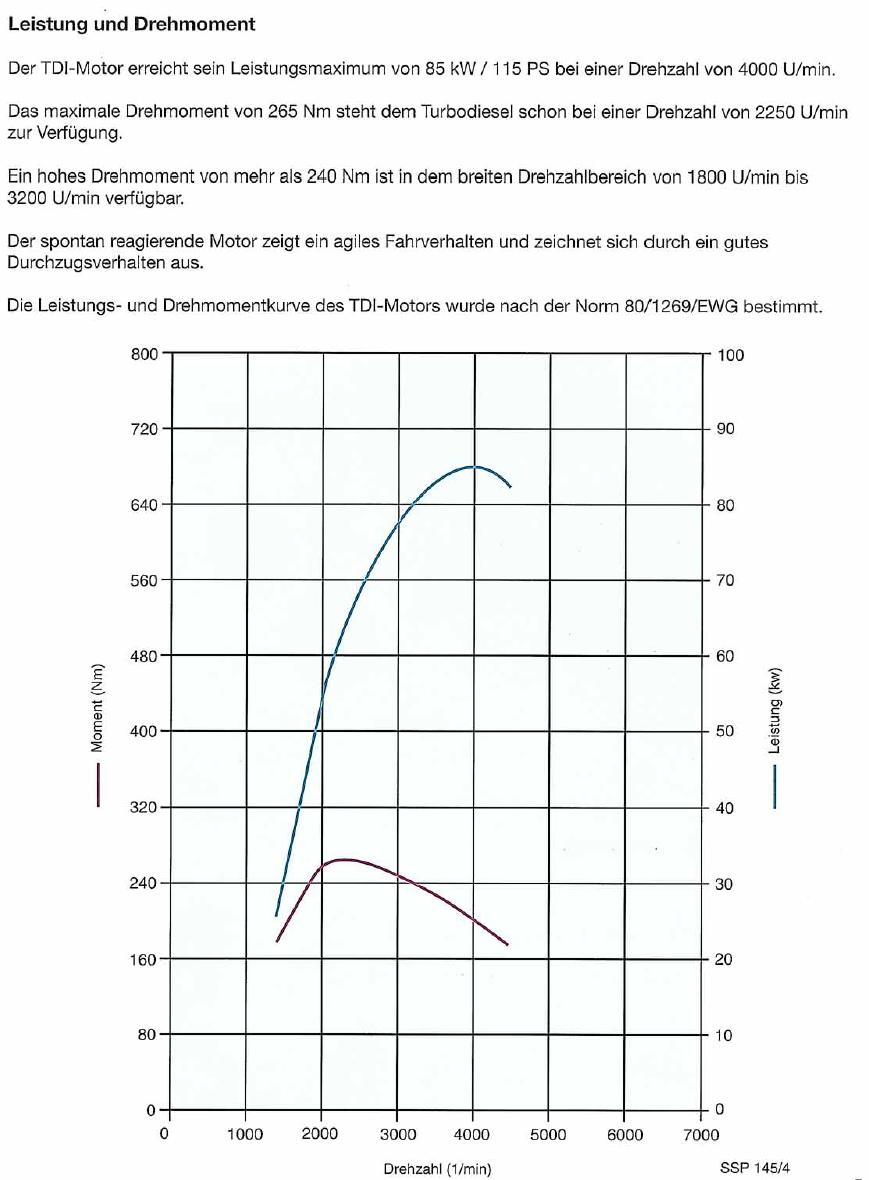

Performance chart of the early Audi 5-cylinder TDI engines, specifically the 1T or AAT models?

The diagram is only available in brochure resolution. The AAT in the A6 already had a dual-mass flywheel.

Post01-12-2004, 16:08    Subject: High-Resolution Torque Specs Online? Quote
It's not great, but maybe it will help.
P.S: Don't believe everything you read above the diagram - it's 1. a kind of advertisement and 2. 10-15 years old!
--> 'The spontaneously reacting engine' - I'm about to fall off my chair from laughter icon_lol.gif.
I once looked up the definition of 'spontan' in the Duden dictionary, and it REALLY means: 'of itself; from within; without external cause; from one's own sudden impulse.' However, I can dispel any concerns that the motor only gives gas at its own discretion icon_wink.gif.
That's all there is to say about copywriting.
 Leistungsdiagramm AAT (Quelle: SSP 145)

Post01-12-2004, 17:21    Subject: High-Resolution Torque Specs Online? Quote
@MarkusViewing profile: Markus
Thank you for the diagram; that's enough for now icon_biggrin.gif.
