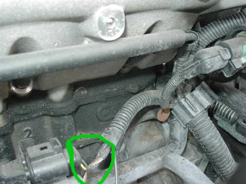

I took another photo today from the other side after removing the cover. I found more of that substance on the head gasket.
http://home.arcor.de/juliahaase/4.jpg
Due to the maximum speed, according to the speedometer, it's just under 200 km/h at 3600 RPM (it's a Variant). So, it's normal; it just worried me. It is said that TDI engines reach their maximum speed at 4000 RPM. Since the speedometer is supposed to have a tolerance, I thought I was only going 185 km/h or so icon_confused.gif icon_confused.gif.

Post09-02-2005, 14:20    Subject: AJM -- Soot on a tandem pump hose Quote
AAAHHH
Are there still such unsightly cable connections on the G4?
I thought they would have installed the protective housings all the way up to the connector by now, as it's supposed to be done.
