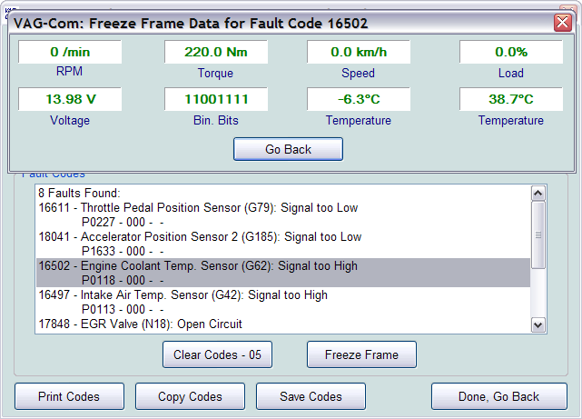

Post21-07-2005, 22:21    Subject: Freeze Frame: A Visual Story Quote
Is that what you mean? But it depends on the control unit.
Regards, Rainer.

Post22-07-2005, 7:31    Subject: Steuergeräte: No Real-Time Data Storage? Quote
Hello everyone,
I hadn't even thought about the data privacy aspect, which is a real shame.
I suspect that the 'Freeze Mode' only works while you are online. But do the data really reflect the exact moment, or perhaps are they from three samples earlier? In the future, when CAN bus becomes standard, this problem will probably be negligible.
From which version is this mode available?
Best regards.
Rainer S.
