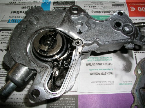

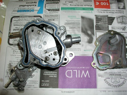

I've now removed the tandem pump, cleaned it, and partially disassembled it. I replaced the seals between the head and the pump (which are available individually). Then, I unscrewed the pump cover and glued it back on with 2K adhesive. I believe that the seal at the 'Y' junction wasn't completely tight.
I'll find out tomorrow morning if that was the problem.

Yay, it worked. I drove the car like an idiot across the highway yesterday, and yet, this morning, it started right up. icon_smile.gif
