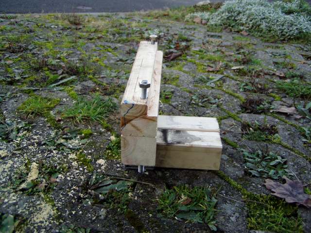

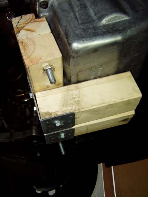

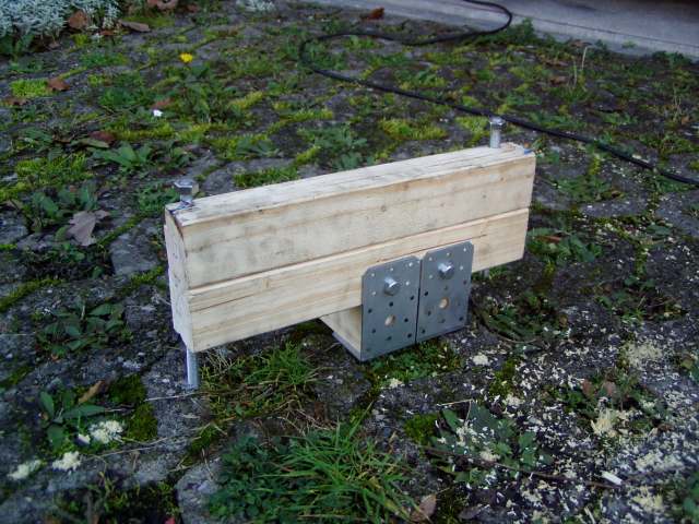

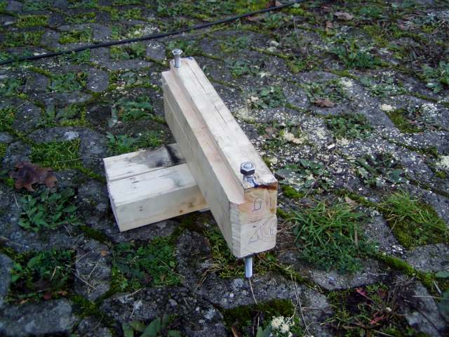

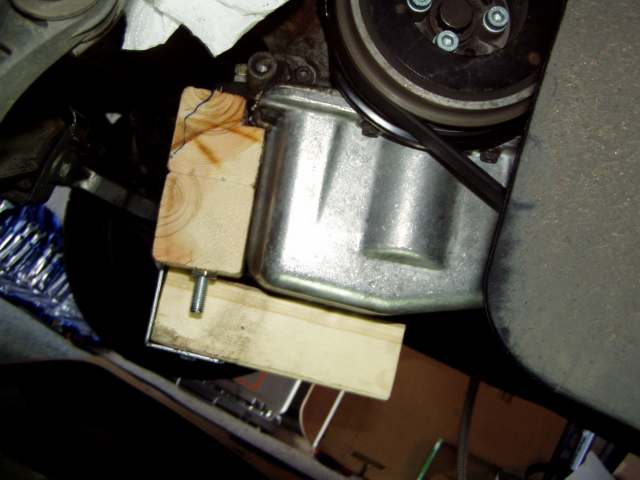

Okay, here's the information and pictures I promised, although a bit late.
By the way, after the timing belt replacement, the engine started immediately, after just 1 second of cranking, and is running perfectly. icon_biggrin.gif
Attached you will find some pictures of my motor mounting device. The two M10 threaded rods pass through the holes on the back of the motor block, ensuring that the bracket can be securely fastened to the block. This prevents any slippage.
The notch is necessary because the oil pan, along with its connecting screws, is located in this area. Only in this way can a flush fit be achieved on the back of the oil pan. Another chamfer is required on the transmission side, as there is a rounded section on the transmission housing.
The entire device is securely bolted to the block. A jack can then be used to apply force directly into the block at the edge.
Here's a brief overview of the key dimensions:
2 slats/beams with dimensions 58x58mm and a length of 350mm (groove 15mm wide, 20mm deep, chamfer on the end approximately 8mm).
2 threaded rods, M10 size, installed with a hole spacing of 310mm.
2 angle brackets, 100x60mm.
2 crossbars, also measuring 58x58mm with a length of 180mm.
If you need more details, please feel free to contact me.
