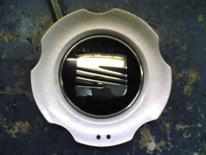

HI,
Is there an official tool available to pry off these wheel center caps from a Seat Leon MJ 01?
I somehow managed to get the parts out of the rim, but it would certainly have been easier with the right tools. Using objects that are too sharp or pointed can quickly scratch the rim, which can lead to corrosion.
Thank you.

I think that thing I have (or had... I couldn't find it recently) would work. It's basically a 2mm thick wire that's bent into a U-shape with the ends bent over, which you can insert into the two holes, then fold over and pull. It should be made of a sturdy wire, but still be easy to bend.

You can also buy these U-shaped brackets from VW dealers - and probably from Seat dealers as well.
8D0 012 244 A
That should be the correct part number.
Or you could ask Seat about part number 6X0 012 243 (although I think that's probably a nose piece).

These U-shaped brackets are also available for purchase from VW dealers - and certainly also from Seat dealers:
You're seriously paying money for about 10cm of wire? icon_question.gif You can easily make that yourself in a minute from a 2mm welding wire or something similar. The holes probably match those of VW.
I can take a picture of that 'mysterious' cap remover tomorrow. It's a real 'special tool' icon_wink.gif.

I would rather make something myself.
"The original wires are far too soft. With very tightly fitting caps (as is often the case with the Allroad), these wire loops regularly bend out of shape."
So, I'd rather make something myself that 1) is sturdy and 2) is also suitable for adult hands!

Regarding durability. The hubcaps are brand new (the previous owner must have neglected to replace the originals), and they fit very securely.
I had wedged a piece of wood into a hole and pushed the lid forward as far as I could, so that I could just fit a finger underneath. Then I clenched my teeth (because the lid was biting), and I managed to pry the thing out.
A tool, whether original or self-made, must be very stable because significant forces are generated when using leverage.
I would say that anything I can bend myself will also end up crooked on the lid.

I always use a very small 90-degree Allen wrench for this. If it's too long, you can grind it down. It has excellent strength. If you slip off the handle, you need to roughen it up a bit.
