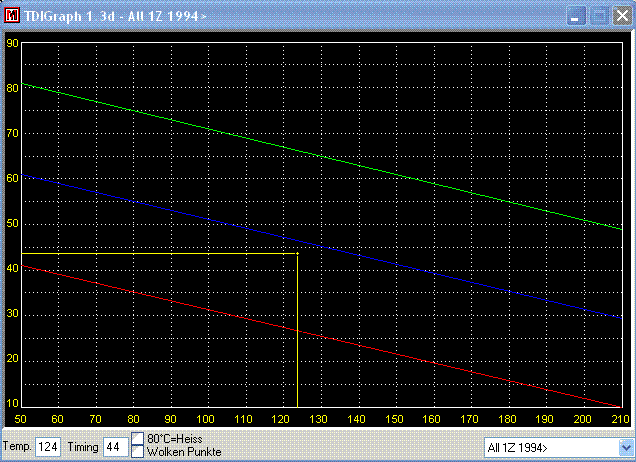

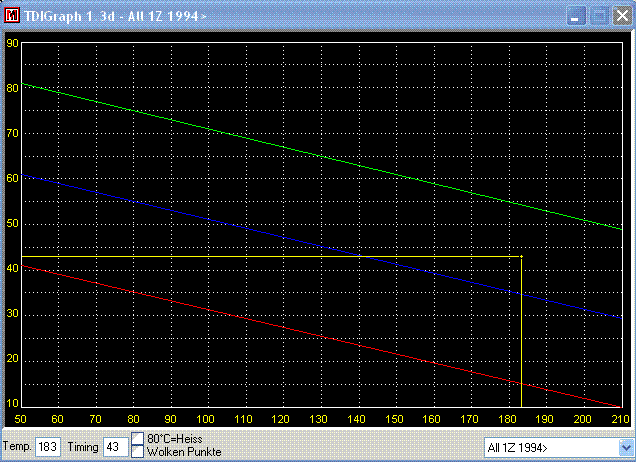

Okay, here's my observation: When adjusting the injection timing using VAG-COM, I noticed that the injection timing doesn't change in relation to the fuel temperature, meaning it doesn't follow the line in the TDI timing checker, but remains constant and shifts along the x-axis. At first, I thought I might not have observed it correctly, so I tried again.

Post10-06-2006, 20:40    Subject: Injection Timing AEL: No Response to Fuel Temp. Quote
Pictures of before and after getting the beer...
 File size:  13.93 KB
 Viewed:  4210 times
 File size:  14.1 KB
 Viewed:  3976 times
Translated on 27-08-2026, 19:25.

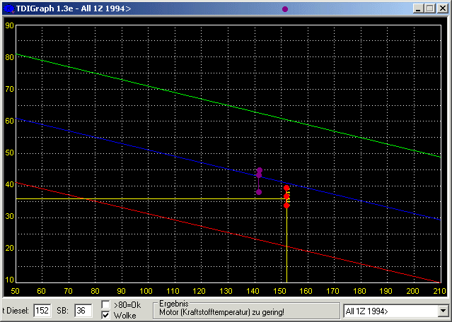

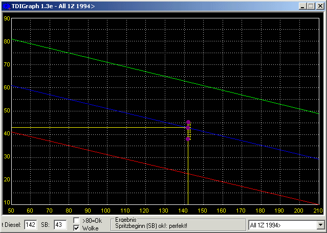

TDII
Guest
Post11-06-2006, 0:52    Subject: Injection Timing AEL: No Response to Fuel Temp. Quote
Just to be clear: around 10:10 AM and 10:30 AM, and it wasn't just about beer...
Okay, I'm curious now! Good night for now, Best, Holger.

Post13-06-2006, 20:34    Subject: Injection Timing AEL: No Response to Fuel Temp. Quote
Does anyone have any more ideas? The differences between Rainer's diagrams and mine are quite clear; while the injection start time follows the curve in his diagrams, it remains constant in mine.
Is there anyone among us who has observed the same phenomenon with AAT or AEL, or who might be able to try the same experiment?
I now believe that the problem is not due to a fault in my EDC system, as a second engine control unit that is already installed does not exhibit the same behavior.
Best regards, Holger.
