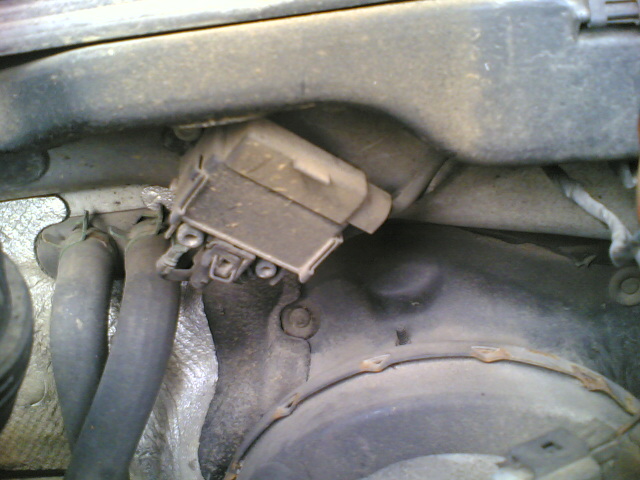

Hello!
I just replaced this relay because the positive terminal was burnt.
and the engine was making such a strange noise at +30 degrees Celsius.
I always thought that was the preheating relay, but I'm not entirely sure.
be, because 1. It's only protected with a 30A fuse, and 2. it's a bit too small for that.
lots of cables attached.
1 x Thick power cable.
1 x Thick derivative.
1x Thin derivative.
1 x 3-pin connector with thin wires.
Is it possible that this relay controls the water heater?
 Foto
 File size:  97.1 KB
 Viewed:  8157 times
Translated on 07-09-2026, 18:13.

Post31-07-2006, 9:30    Subject: Relay Explained: What Does It Do? (Image) Quote
And in which car is that thing installed?
A4 Avant 08/01 AWX 05/08-
Translated on 07-09-2026, 18:14.

Post31-07-2006, 9:59    Subject: Relay Explained: What Does It Do? (Image) Quote
It looks like a Golf 3.
Is that the relay for the coolant heater?
Translated on 07-09-2026, 18:15.
hollari
Guest
Post31-07-2006, 10:03    Subject: Relay Explained: What Does It Do? (Image) Quote
Oops. It's a Vento TDI.

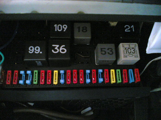

hollari
Guest
Post02-08-2006, 20:26    Subject: Relay Explained: What Does It Do? (Image) Quote
Hmm.
Today, I briefly removed the light switch.
'I also removed the cover so you can see the fuses (photo) and relays.'
sees.
But it requires a 50A fuse and a 'larger' relay.
Unfortunately, I couldn't find anything.
I might take it apart again sometime, maybe I'll find something then.
Translated on 07-09-2026, 18:18.
Arne
Guest
Post03-08-2006, 10:59    Subject: Relay Explained: What Does It Do? (Image) Quote
The component located in the bottom right corner (103) in your photo is likely the glow plug relay.
Regards,
Arne.
Translated on 07-09-2026, 18:19.
hollari
Guest
Post03-08-2006, 13:27    Subject: Relay Explained: What Does It Do? (Image) Quote
Aha.
Let's try to tap into this and connect an LED.
Translated on 07-09-2026, 18:20.
hollari
Guest
Post22-09-2006, 14:10    Subject: Relay Explained: What Does It Do? (Image) Quote
Okay. That's correct.
I connected a wire from pin 85 and connected a button (to ground).
If I press that, it will 'light up' (you can tell by the interior lighting).
