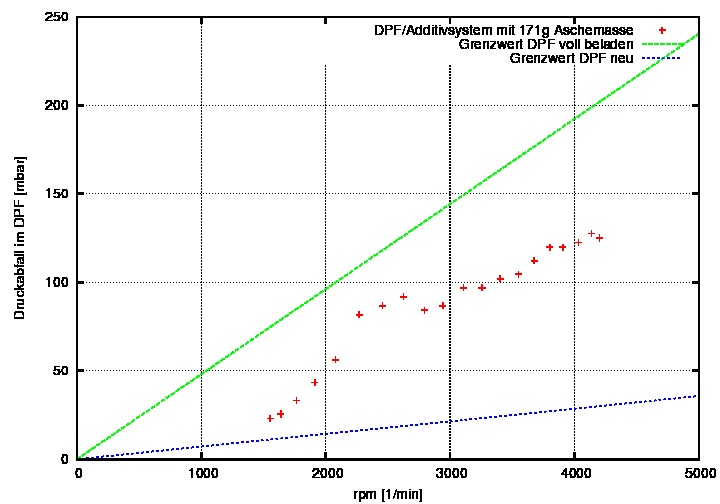

To estimate the effect of filter flushing, I measured the back pressure using G450/VCDS, measuring block 67.3, while the filter was still full and un-flushed.
The SSP 330 document, "The diesel particulate filter system with additive," contains some information regarding the pressure drop of the DPF.
On page 17, there is a diagram that shows the differential pressure (pressure drop caused by the DPF) as a function of the exhaust flow rate. According to this diagram, a full DPF results in a pressure drop of approximately 250 mbar at an exhaust flow rate of 500 m³/h. For a new (empty) DPF, the pressure drop at this exhaust flow rate is approximately 40 mbar.
Unfortunately, I can't measure the exhaust flow on my TDI. I've simply assumed that I produce a flow rate of 400 m^3/h at full throttle and 4000 rpm. Based on this conversion, the following graph was created, which shows that my DPF is not yet at its limit. However, be aware that the validity of the characteristic curves from the SSP depends on and is limited by the conversion between engine speed at full load and exhaust flow.
Here are a few more questions about this:
Does anyone know the physical unit of MWB 67.3? I assume it's millibars.
Does anyone happen to know the exhaust flow rate at full load for the TDI engines?
Otherwise, I'll just sit down and calculate it based on the boost pressure, the amount of CO2 produced given the fuel consumption, and the exhaust temperature in the DPF.
Best regards, Georg.

Post29-08-2010, 21:00    Subject: Night Hike: Explore Nature After Dark Quote
Hello everyone,
Here's a rough estimate of the exhaust gas volume flow produced by our TDIs.
Assumptions:
The ideal gas equation is valid. It's an approximation, but it's quite accurate at high temperatures.
* The pressure is determined exclusively by the air particles, which only become hotter due to the diesel combustion. The additional mass introduced by the diesel injection process is neglected. This causes only a small error: The average chemical formula of diesel is C12H23 (source: Wikipedia), which results in a particle number balance of...
C12H23 + 21.5 * O2 --> 12 * CO2 + 11.5 * H2O.
On the left side, there are 22.5 particles, while on the right side, there are 23.5, which is only 4.44% more.
Approach:
A specific volume V1 of air is forced into the combustion chamber per crankshaft revolution by the turbocharger, at a pressure p1 and temperature T1. Inside the combustion chamber, the air is heated by the diesel combustion process, and it exits the exhaust with a temperature T2 and pressure p2.
The ideal gas equation is used to calculate the ratio between the initial and final volumes as follows:
V2/V1 = (T2 * p1) / (T1 * p2)
VCDS/Vag-Com zeigt bei mir eine typische Abgastemperatur im DPF von von ca. 300 Grad Celsius bei typischer Vollast an, also ca. 600 K an. Den Druck im DPF schätze ich auf 1.2 atm. Der Turbolader schaufelt Luft mit 2.5 atm bei einer geschätzten Temperatur von 400 K in die Brennräume. Es therefore, it results in...
V2/V1 = (600 K * 2.5 atm) / (400 K * 1.2 atm) = 3.125
A 2.0-liter 4-stroke TDI engine, operating at 1000 revolutions per minute with the specified turbocharger pressure and temperature, draws in a volume of...
0. 5 * (1000 /min) * 0.002 m^3 * 60 min/h = 60 m^3/h
The factor of 0.5 arises from the four-stroke operating principle.
Due to the volume expansion, the current flow rate of 60 m³/h must now be multiplied by the factor of 3.125 calculated above.
We have an estimated exhaust flow rate of 3,125 * 60 m^3/h = 187.5 m^3/h at 1000 revolutions per minute.
At 4000 revolutions per minute, the corresponding volumetric flow rate is 750 m³/h.
With the above conversion, the diagram will then look like this: (attached)
 mit VCDS gemessener Differenzdruck im DPF bei Vollgasbeschleunigung von 1500 -- 4200 rpm. DPF hat eine Aschemassen von 171 g, ist also eigentlich Austauschbedürftig. Vor der Messung wurde eine Zwangsregeneration durchgeführt, so dass der Rußbeladungskoeffizient bei Null lag.
 File size:  9.16 KB
 Viewed:  6313 times

Post24-03-2011, 21:09    Subject: DPF Questions: Skoda Superb 3U (BSS) Quote
Georg_G wrote:
Based on this diagram, a full DPF results in a pressure drop of approximately 250 mbar with an exhaust flow of 500 m^3/h. For a new (empty) DPF, the pressure drop at this exhaust flow is approximately 40 mbar.
*entstaub*
Does anyone happen to know any benchmark values for typical TDI catalytic converters at their respective engine maximum power output?
For example, one could perhaps provide concrete figures to support the statements often found on champagne corks.
Translated on 28-08-2026, 19:00.
