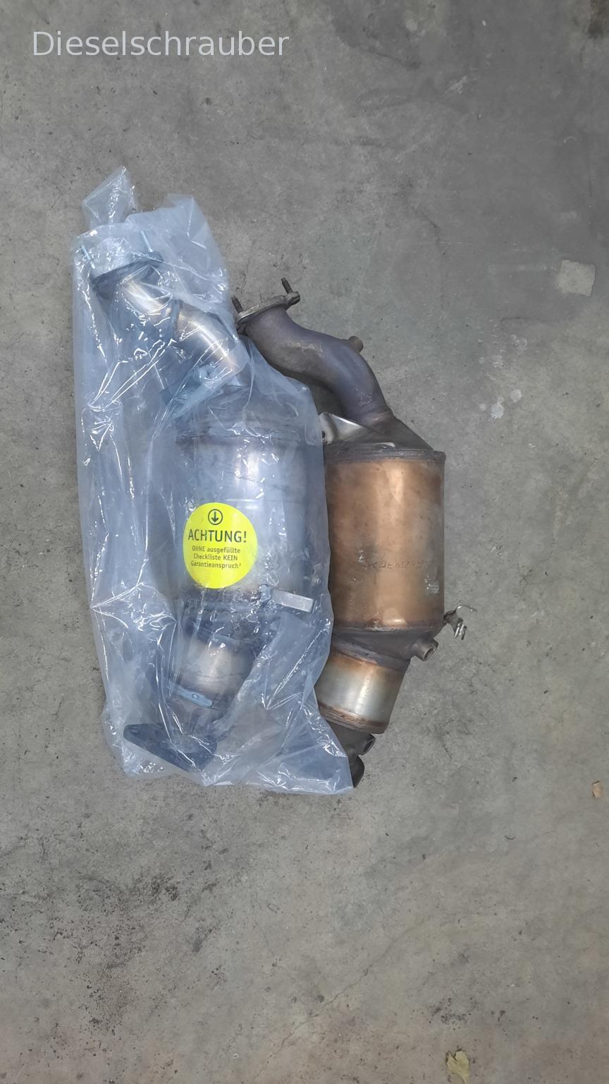

Post19-09-2022, 18:54    Subject: 2.0 TDI: High Fuel Consumption - CGLC Engine Quote
Okay, the DPF was cleaned, but the replacement part from ERNST didn't fit.
I'm now curious to see how much energy it consumes...
"The software update was performed at 53,000 km. I suspect it might have been driven with a power box installed, which could explain the high ash content."
 File size:  1.61 MB
 Viewed:  535 times
