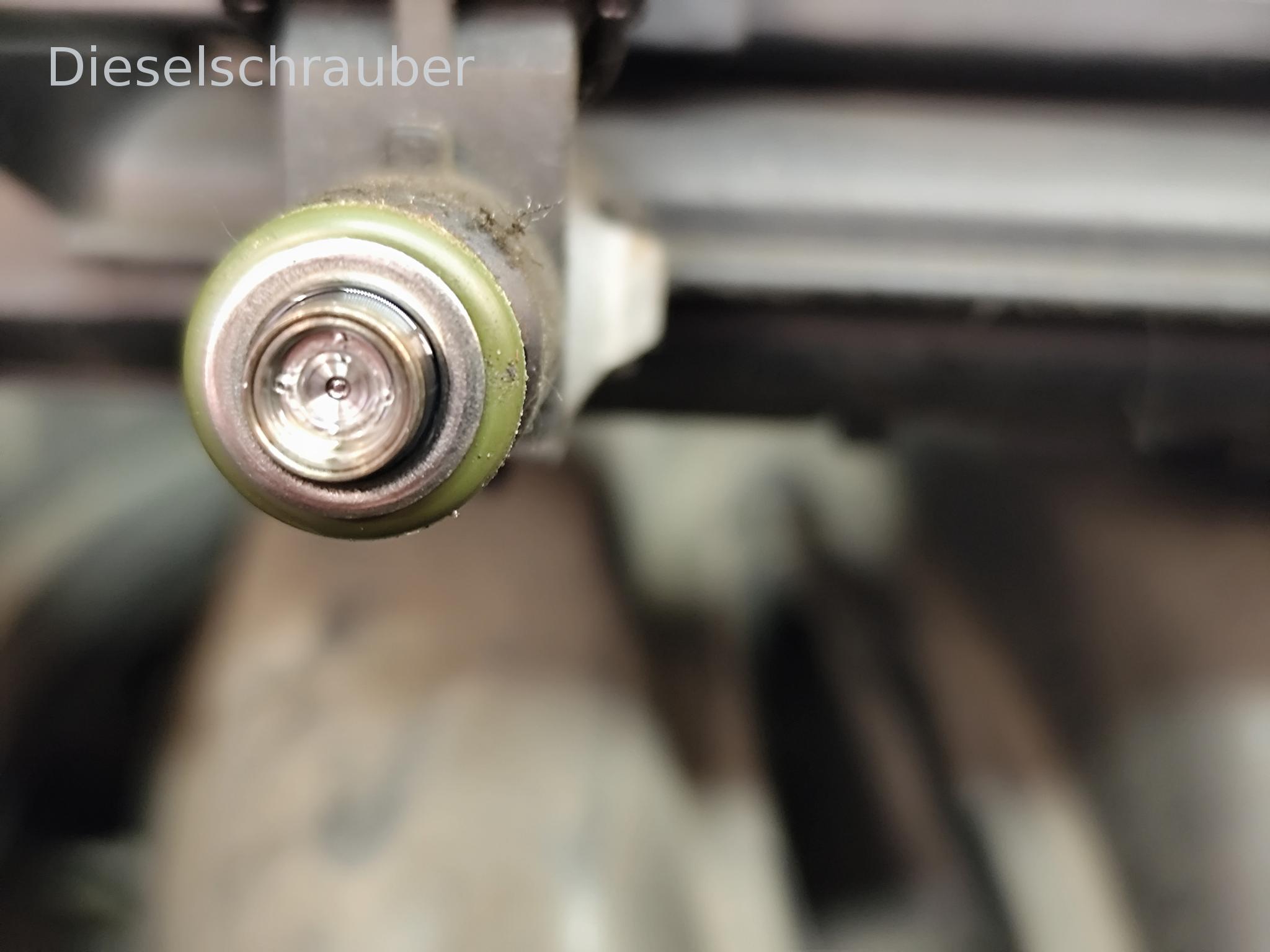

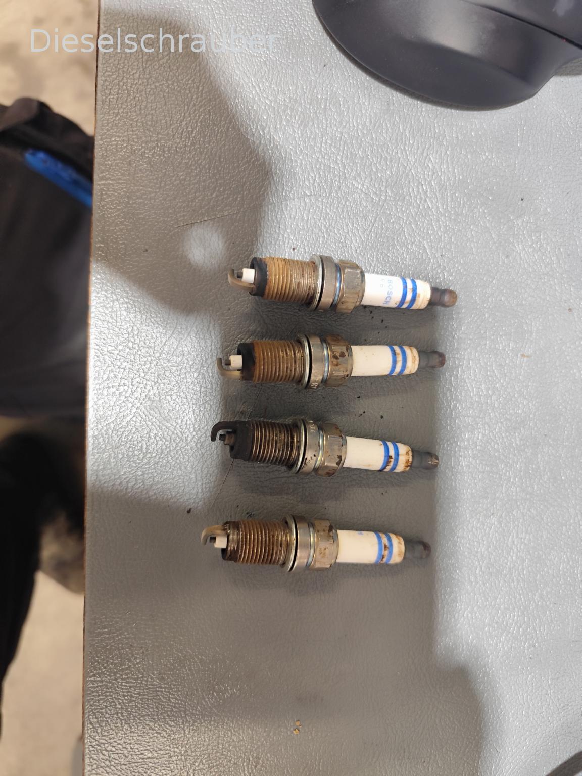

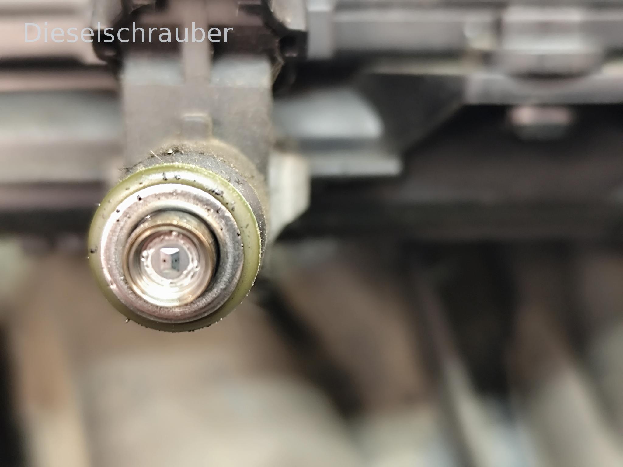

Meanwhile, the MKL (likely a diagnostic system) was also activated, and there were 2 error memory entries indicating combustion interruptions. Cylinder and lambda control system: mixture is too rich.
"I then removed the spark plugs and immediately noticed that the second one..." The spark plug was "wet" and black, indicating an incomplete combustion or excessive fuel injection.
So, I removed the fuel distribution rail and quickly found the mechanical fault on the injector - the front part, which is responsible for atomization, was completely missing.
"I took the opportunity to replace the seals on the other three fuel injectors as well, and I also changed the spark plugs again (they had been installed for about 11,000 km)."
The pictures should explain the rest relatively well icon_wink.gif.
