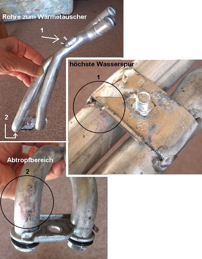

Earlier, I removed the pipes leading to the water treatment system and found one defective section: see item No. 1 in the attachment below. Therefore, the pipes definitely need to be replaced.

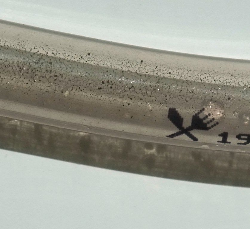

I'm not entirely convinced that this is the sole cause of the water loss. The used test hose had black deposits in it, for which I haven't found any other explanation besides soot from combustion gases, which again suggests a problem with the cylinder head or head gasket.
On the other hand, I have never noticed any soot particles in the expansion tank icon_eek.gif.

Because black grime had accumulated in the used test tube, for which I have so far found no other explanation than soot from combustion gases, which again suggests a problem with the cylinder head or cylinder head gasket.
If it was soot, that's fine. --> Still, continue to monitor the situation.
If it's oil droplets, the oil/water heat exchanger (oil cooler) would be a likely culprit.
If this were to leak badly, it would be a real mess.

At least, that's not how it looks with the Polo, because the symptom
In this vehicle, the coolant reservoir is completely full to the top edge with clean black engine oil
hasn't even shown up in a drip yet, and those would have to be floating on top.
I haven't noticed any water on the dipstick so far either.

Were the pipes leaking? I wouldn't be surprised, considering how poorly those welds were done.

Were the pipes leaking? I wouldn't be surprised, given those sloppily prepared welds.
Yes, see https://community.dieselschrauber.org/en/viewtopic.php?t=26626&start=45.
