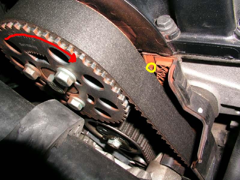

I chose the Russian method icon_wink.gif. As a probe, I used a bare welding electrode.
Image 1:
The red arrow indicates the direction of rotation, and I only rotated in that direction.
The yellow circle highlights a small section of the metal nose.
This image shows the position where the piston has reached top dead center (TDC). No forward movement of the rod is visible anymore.

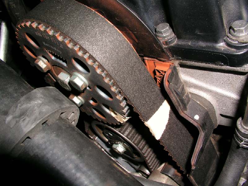

Image 2:
Show the position where the piston is visible again as it moves downwards.
In image 1, I have marked the position of the metal nose with masking tape.

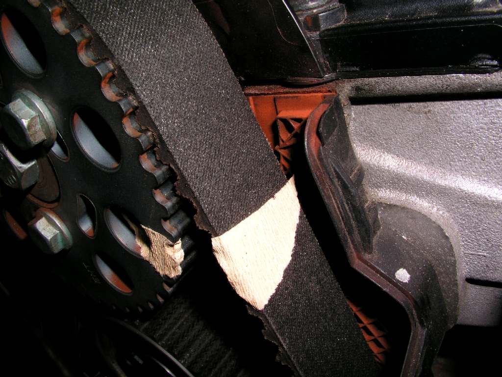

Image 3:
The image shows the front (NW) wheel. Masking tape marks the position of the metal tab and indicates when the top dead center of the piston is reached.
Is the OT point on the flywheel located at the midpoint between reaching and leaving the OT position, or is it at the point of reaching the OT position?
I have tried the positions multiple times and always gotten the same results.

Is the point OT on the flywheel located at the midpoint between reaching and leaving the OT position, or is it at the point of reaching the OT position?
The OT mark indicates that the piston is at Top Dead Center, which is between the positions where the piston "remains stationary" and "begins to move downwards."
While I don't quite understand your markings, it's right in the middle between...
"Piston stops" and "piston starts moving downwards" should allow the NW (presumably a control or valve) to be switched off.
If that is the case, then the N/W setting is incorrect, or the Z-axis is not properly adjusted - subject to measurement errors in your O.T. determination!
