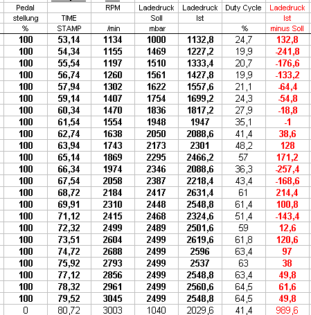

"Hey everyone, here's the requested log data from the MBW 3-10-11, recorded in sixth gear while driving at a constant speed. During this test drive, I also noticed two instances of power loss, which I was able to reproduce."

Post31-08-2005, 20:12    Subject: ARL: Delayed boost pressure build-up again Quote
Zak1976 wrote:
Here is the requested log of the MBW 3-10-11 from the RPM range at low speed in 6th gear.
Okay, but unfortunately, I made a mistake in the MWB: 008 should have been included with the limitations, which are 3, 8, and 11 icon_redface.gif.
Well, even like this, you can see that the boost pressure in the engine isn't too bad: it reaches the target value at around 1500 rpm, and that's still acceptable for an ARL, I think.
According to the data log, the measured air mass is exceeding the torque limit starting at approximately 1500 rpm. Therefore, even with a better mass airflow sensor (MAF), I don't expect to see a significant increase in power output.
However, a log from a similar vehicle (MWB icon_cool.gif with the same driving profile would provide more accurate information.
