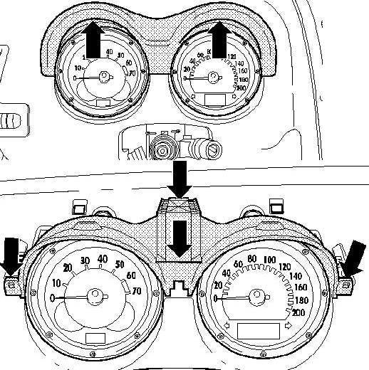

I was looking for something earlier.
Maybe this will help you a little bit further.
The screws for the trim should be located where the arrows point.
Then the speedometer will only be held in place by two screws on the top edge.
Best regards,
Rudi

bloesch
Joined: 03/18/2005
Posts: 622
Location: FL
Post15-02-2006, 21:43    Subject: Dashboard Lights On? Fix It Now! Quote
.oO( I never even noticed those screws before...)
