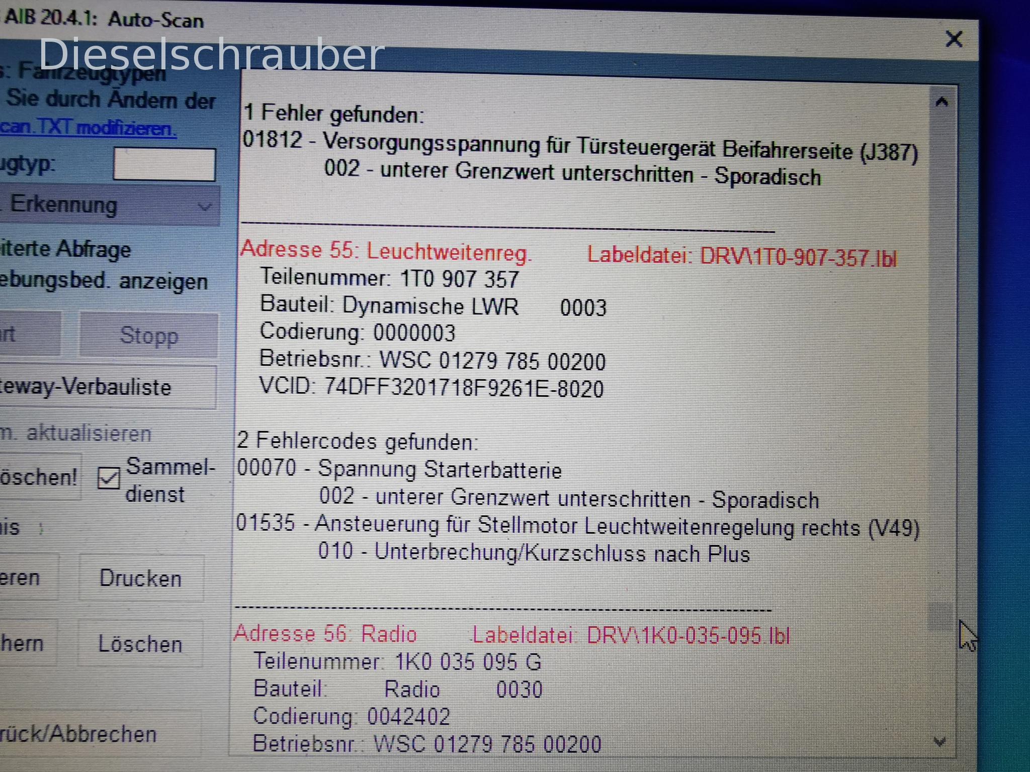

Post02-11-2022, 15:33    Subject: Headlight leveling error code 01538 Quote
I'm experiencing the same error. How did you fix it? Sorry for reviving this old thread; I just didn't want to start a new thread with the same title.
The error code scan is attached.
