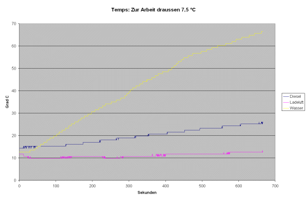

Here's my measurement from this morning.
A waste heat recovery system could have saved a significant amount of energy that would otherwise have been lost to the ESP.
