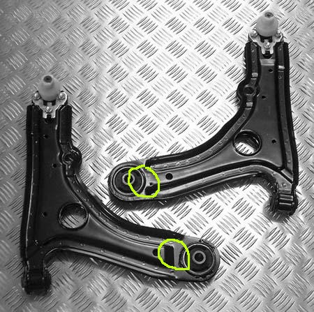

The cars weren't much older/hadn't been driven as much as my Golf 3, and they always worked perfectly. He even ended up on the side of the road, in the ice and snow, because his colleague lost control on the ice and swerved into him.
Apply plenty of rust remover/WD-40 and take a coffee break first. Then use good tools, so you only have to apply force once, instead of constantly fiddling with the screw.
I generally replace screws because being stingy with those 2-3 euros is definitely the wrong approach. However, it does require preparation, as you need to buy the screws in the first place.
I just saw that the QL values are not symmetrical... are the original ones not symmetrical either? In the area of the rear bearing, they exhibit a deflection in only one direction, which results in the bottom being on one side and the top being on the other side!!?

The photo is from a website. Although, this offer seems somewhat legitimate. At least the ball joints are bolted with a washer plate, not with 3 loose nuts, and the photo shows 2 genuine control arms, not a dizzying photo montage.
Currently, I tend to use VW vehicles for pressing and releasing operations. I need to ask what they want for the parts and the re-crimping.

I'm not sure about this, but I believe the QL units I bought cost around 70€ each (we somehow get a discount, but it's not much)... I'll check again.
The QL components are as shown in the photo; they are mirror-symmetric, which explains the different pressing patterns and the different part numbers.

The G3 QL models do not have different part numbers, not even at Volkswagen.
A complete VW QL costs 86 EUR.
Either the VW parts are truly symmetrical, or they have the same pressing processes, meaning that the "indentation" appears both on the top and the bottom.
I'll take a look at that today.
