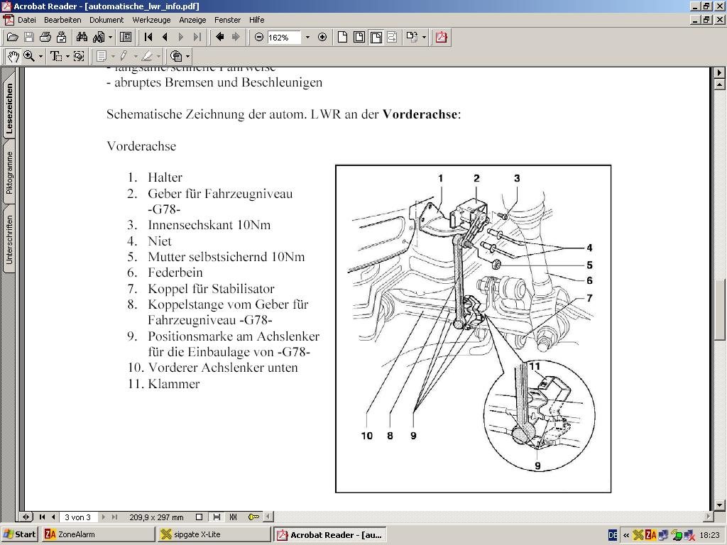

Post11-09-2006, 19:22    Subject: LWR Sensor Check: How to Test & Diagnose Quote
Okay, I'll take a look at the car and possibly remove the wheel. I found a picture online, but it's from an A4, so it might look similar on my Passat.
Does anyone have a schematic? The sensor is just a resistor that changes value. I'm interested in knowing which pins I need to measure between.
Best regards,

Post11-09-2006, 19:27    Subject: LWR Sensor Check: How to Test & Diagnose Quote
Here's the picture.
