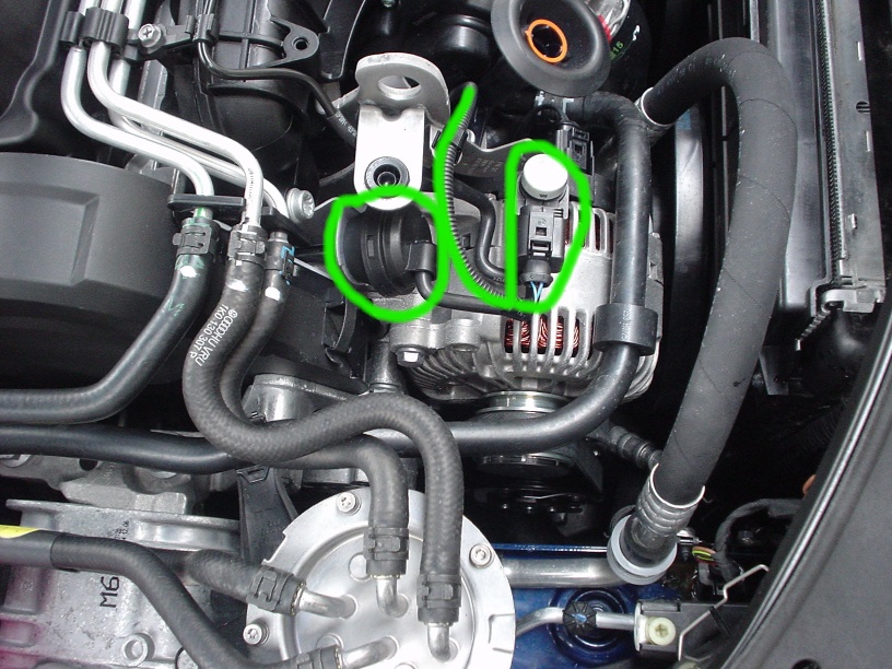

HI,
another riddle:
What does the green-bordered valve do on the BMR?
The photo was taken standing next to the right fender. The valve's operating rod is connected somewhere near the intake manifold or its vicinity...
 Druckventil am BMR Motor.

Awkward counter-question:
Your BMW should have a swirl flap in the intake manifold, right?
http://www.tuneline.at/news/images/2005_2l_tdi/bild4.jpg
http://www.tuneline.at/news/detail.asp?start=99

I almost thought that, but for some reason, I was sure he didn't have one.
"Thank you."

Does anyone know when the intake manifold switch activates?

Does your BMR actually have an EGR cooler? I once heard that the piezo injectors no longer have an EGR cooler.

Hello everyone,
BMR engines all have an EGR cooler.
The variable intake manifold is needed in the partial load range to provide better swirl of the incoming air.
The valve is for the bypass air duct.
Regarding the question of why use a plastic suction tube, it's about weight reduction and cost savings...
