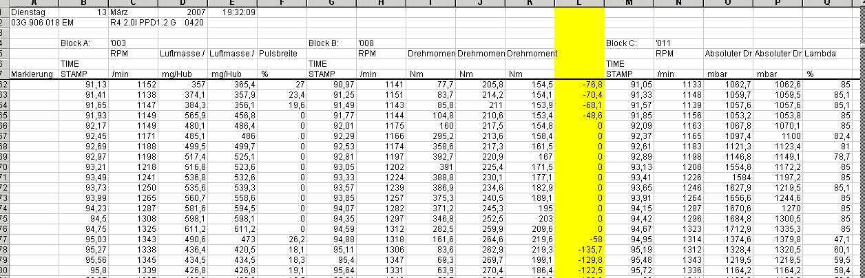

My BMR (and also my BMP) are not reaching their minimum operating range. At least, my BMR is running right along the Russian border until it finally builds up boost pressure. At this time, the PWM is at its maximum value of 85%.
Should I twist the rod icon_wink.gif?
(yellow indicates = min(three rotation speeds) - Russian zone --- so 0 if the Russian border is reached).
 BMR doesn't want to go down

I'm afraid that won't help: Take a look at MWB 3; it precisely regulates the desired air mass. If you mess with something on the engine, it will likely just further damage the EGR valve, and you'll be no smarter than you were before (plus, the intake passages will get dirtier faster).

MWB3 also confused me as well. On the one hand, whether it "fits" and, on the other hand, how precisely it fits.
You can even hear it while driving; it has a characteristic valve sound because it produces "modulated noises" that are atypical for a diesel engine, specifically from the "throttling of the intake passages."

He also runs along the area with the "Truebungkennfeld," just like mine does...

Could this behavior simply be due to the mechanical design (size) of your turbocharger?
Given the engine displacement, your turbocharger should already be a high-performance unit. Therefore, he drives along the smoke limit line as long as the turbocharger is not at its maximum speed.

Okay, so if the soot limit is reached below 1340 rpm... I think there are worse things. icon_smile.gif

Yes, yes, the old story: As power output increases, so does the size of the turbo lag (unless you're forcing a mini-loader to astronomical RPMs with a "wooden hammer" chip tune, but instead using a turbocharger that's appropriately sized for the maximum power).
Even the VTG principle is not powerful enough to completely eliminate this problem. Therefore, the models with 100 horsepower are more suitable for city driving than the higher-performance versions within the same engine displacement class.
