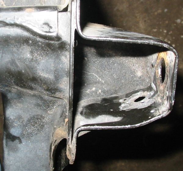

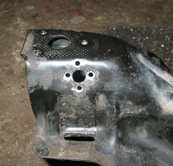

Post15-04-2007, 17:17    Subject: Thread Repair on Engine Mount: Success! Quote
The thread repair worked. As suspected, the engine carrier can be removed relatively easily. To remove the damaged threaded parts, I had to carefully extract the support sleeve from the engine carrier. Using a Dremel, you only need to grind off the three front pressing points, and then the sleeve can be pulled out. The damaged threaded parts can be easily pried out with a chisel or a sturdy screwdriver, as they are only spot-welded in place.
As a replacement, I turned two M8 threaded bushings, approximately 10mm long, from 18mm round stock. To weld them in, I drilled four additional 4mm holes around the existing hole and countersunk them. From the top, the new sleeve can now be easily positioned for welding. For extra security, I also welded them slightly from the back. Now, the support sleeve needs to be reinstalled and also lightly tack welded in place.

Post15-04-2007, 20:45    Subject: Damaged Threaded Bushing: Repair on Engine Mount? Quote
"Looks good. I thought that profile was closed, which is why I suggested replacing the thread from the outside. Of course, this is even better, and the structural integrity isn't compromised either."
